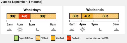

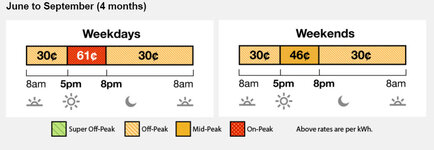

There are different plans you can choose from. They are basically forcing everyone by default on to Time Of Use plans, and depending on what is considered Prime, the price can vary substantially
So ya, if you want to pay $.08 more per kWh so you can say your going green, they will have no problem charging you $.69 from 5 to 8 PM on that plan... This is what SCE would charge me. (I am on a grandfathered tiered rate plan)
TOU 5 to 8 PM summer
TOU 4 to 9 PM Summer
HamAndEggs
Nov 16, 2020
932
Houston, TX
Holy Bananas, those On-Peak times are crazy!
Running my generator costs around 13c/kwh at 25% load, would be cheaper to switch to than than pay those
