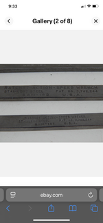

30,574
I just discovered them and I think they are pretty cool!
You may be surprised to learn that they date back to 1891 - and Florida, of all places. :)
Here's a handy chart I made...
If you want to read further - warning, it's a long read, but there are plenty of photos, I did a deep research dive on them on a thread here.
