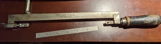

Here's one I have not seen in this thread. My favorite online tool monger had this one, and I am a sucker for different hacksaws, so I grabbed it. Nothing near a steal, but fun and different. My other two low profile hacksaws are home made, or school shop made, so nice to see one from a major mfgr. Only downside: it uses 8" blades. Good news is my blade punch will poke holes in 12" blades so I can still use it.
Bonney 2625, seen in a few catalogs, 1957 - 60 at least.
