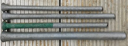

I scanned the last few posts, but I’m not sure the search and discussion of nut starters included a comparison to tube benders.
IMG_7529.jpegThey are longish helical springs that widen at one or both ends, used by hand to put a smooth bend into soft copper tubing without kinking.
IMG_7526.jpeg They come in a few sizes for common sizes of copper tube. I can easily imagine someone picking one up, experimentally jamming a nut into the end, and thinking, “this could come in handy!”
I have not seen wood-handled nut starters in the wild, but the catalog illustrations and descriptions give me the impression that they are essentially tube benders with dowel handles.

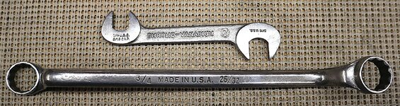

An old B-shield non-symmetric-profiled DBE. Anyone know about the bottom wrench?
Which Todd ID'ed for him.
...battery terminal wrench.

Here are a couple of Bonney wrenches (I think). The smaller one is marked Bonney and is an obstruction wrench. The sizes are pre 1930 where it is sized to the bolt head instead of the thread. However, it is also marked with "Made in U.S.A.". The second one is not marked with the Bonney name or a date code, but does have the "Chrome Vanadium Steel" which was a trademarked name. Any ideas on when these were made? Thanks. (Edit: I said it was made after 1930, but some makers use the COO before it became law. I stand corrected.
30,979
The "R" in the date code and the embedded Princeton shield branding ("BON{/}NEY") date the obstruction wrench to 1926.
(I'm not sure where you're getting the info that 'MADE IN U.S.A.' comes after 1930.)
The second wrench was made by Duro-Indestro. Bonney TM'ed a stylized form of "Chrome-Vanadium" (note, with a hyphen) - as well as the abbreviation 'CV', but did not own all rights to all forms of the name of the steel composition itself, which was used by many mfgrs. DI used "Chrome Vanadium Steel" branding.

You right. I corrected it. Some makers did use COO before it became law. Apparently Duro was one of them.
