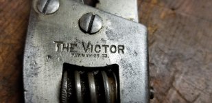

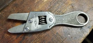

Here is my oldest dated "Bonney" tool. I use quotes, conspicuously, because this adjustable "alligator" type wrench was patented by C.S. Bonney on May 26, 1903, after he sold Bonney Vise & Tools Works, when he resided in Portsmouth, Ohio, but it was made by Kraeuter. The date, which was put on both pieces of the two-piece tool, refers to 728,842.
