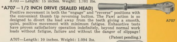

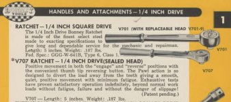

The V707 is first introduced on p5 of the 1960 catalog, with a note that “Notice will be made from factory when available for shipment.” The T707 is introduced on p11, with the same note.
I think when rolling out a new design, it makes the most economical sense to start with the model that will generate the most sales revenue, which in that period was probably the 1/2dr. The number of steps is about the same for smaller rats, and miniaturizing the design probably translates to more quality control rejects, so despite using less material, 1/4dr and 3/8 dr were probably more expensive to manufacture than 1/2dr.
Edit- flawless logic, totally ignoring the facts. All three sizes in the 707 design came out in 1960.
LesserSon
Feb 7, 2016
5,123
PA USA
Oops, there I go again: speculating before scrutinizing. Somehow I thought Lugz had found the A707 in the 1957 cat.
The A707 is ALSO introduced in 1960 cat p19 with the same “factory” notice.
Screenshots...
