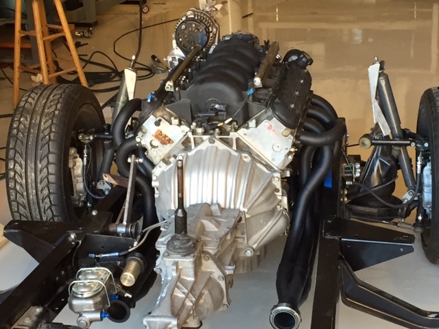

I've built my own version of the ICE cutting tool out of wood, but to be honest, after a while it was just too fussy to use.
I have the ICE tubing 'legos' to build headers in plastic, then transfer the dimensions to the mandrel bends.
To get a square cut, I take a pair of dial calipers and place it over the tube and wiggle it until I get the minimum dimension and mark it with a Sharpie. The minimum dimension on the dial will define the cut that is a 90 degrees to the center line of the tube. If the mandrel bend is good, it will be a perfect circle and you can weld a straight pipe onto it with no problems. I don't usually connect the marks from the outer radius of the tube to the inner. but I sometimes will take a worm clamp and slide it over the tube to connect the marks.
I make all my cuts with a Portaband mounted to a SWAG table and controlled with a HF foot switch.
To square up the cuts I have a larger stationary belt stander with a cast iron table. I square it at the start of every fab session. Once the tube end is flat, I check it for fit with its mating tube. I'll adjust it a little out of square if I have to for a best fit. Steel tube is pretty easy, but the spring back on stainless is a pain in the ***. I don't want to see any light in the fitup and no more than about .010" step in joint. I can sometimes cheat a little by squeezing the tube in a vise to get the shapes to match a little better.
My belt sander setup.....
full
The Portaband on a SWAG table. The belt sander next to it is great for quick touchups
full
I made these to tack weld tube together
full
Some headers I made for a truck project - just tacked and not welded yet
full
Little better view of the fitups- the tube sticking up is a mockup of the steering shaft that had to go through the headers
full
Right or wrong, that is what works for me

The truck chassis that the new exhaust system is going into is this..............
full
After ceramic coating.........
full
