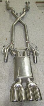

Fix Until Broke, this is a great thread but a little late for me. A few years ago I bought a Magnaflow system for my '72 Big Block Corvette.
Installed it in the car but the head pipes didn't come close to matching my ****** headers. Made aluminized steel head pipes and hated them. Made 2.5" stainless head pipes and liked them better. Then I made 3" pipes from the headers to the crossmember and reduced them to 2.5" to match the Magnaflow system behind the crossmember "While I was at it" I cut up the two mufflers, modified a single dual-inlet, dual outlet muffler with quad tips and added a couple of electric cutouts (I'm really old and can afford the tickets). My first time welding stainless, using MIG for most of it.
I really like those clamps with windows you made but I cheated and bought the [more expensive] ready-made Exhaust Welding Clamps from Summit (lots of different sizes).
