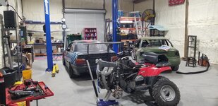

At the shop I work at all the standard lifts are 11'8" to the top of the cross bar so 12" is fine but the "Truck" lifts aka diesel lifts are 13'6"

I have a 30x50. Half of that for a lift, a second car, and work space would be very tight. Unless you're storing one on the lift. What you see in this picture is about 30x30.

Are you sure you can fit two cars in 30’ of length? If you’re planning on this happening I’d go measure it. Google says they are each 15.8’ plus you’ll have the thickness of the wall and garage door.
Yeah, I have a 10x30 that I am storing them in now. Its only 28.5 long according to my laser measure. The cars are 159 inches long, so it's snug, but they fit just fine. What is that? Roughly 26 feet for both of them plus a little extra.
What car are you measuring that's 15 feet long?
TobeyA
Apr 7, 2021
254
TX
My cars, truck and SUV not included
2016 Mustang: 188"
2005 GTO: 190"
'98 BMW M3: 174"
