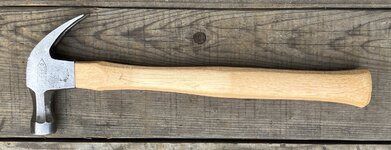

I picked up one of those Stiletto framing hammers for a couple bucks at a swap meet a couple years ago. I never really understood the advantage of a titanium head on a hammer though. I like a bit more weight (steel) with less bulk in a framing hammer head which also allows for a shorter handle. Still an interesting idea though. Maybe I'm missing something. The nail starting notch is handy. Ed.

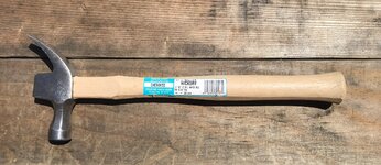

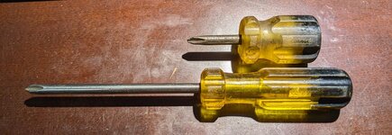

Couple of Stiletto screwdrivers, by Bridgeport (License 7, plus the color of the handles) From a GS in the town north of me, so they didn't wander far from their home.
Larger is s 4" shank, 7-3/8" OAL, Stubby is 1-3/8" blade 3-1/8" OAL
Also scored a 20oz framer's Rip hammer head, but I don't think it's a vintage one, so we'll keep it away.
Force (as in hammer-to-nail) goes up as the square of the velocity with which the hammer head hits the nail head. A titanium-head hammer can be swung at higher speed than a steel head, especially when the titanium head is combined with a longer handle, as in most framing hammers.
Shorter version w/o the physics: More POW for less effort.
