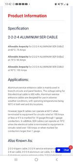

This was what I had been finding for aluminum cabling. Would I need to go for a cable gauge rated for 120A or higher to achieve my 80% load rating? What size ground? This site recommended 4 gauge copper ground with 2 gauge wire. I'll be operating in the 75°C bracket given all the breakers I've purchased are in that temp range.

Not only is that wire missing the ground, It would require conduit the whole way. Plus, it looks like URD, which can't be used indoors.
Unless you wNt to run conduit, just buy 2-2-2-4 AL SER and breaker it at 90 (or less). Using a 60a breaker would save a chunk of money and it might be easier to source.

I plan on installing a 100A breaker in the sub-panel at the top where a "MAIN" usually would reside (as a disconnect). I'll have the 90A breaker in the main panel supplying the power. I found a 90A breaker by accident and snapped it up. I'm going to replicate this project in my barn when I get the chance. My base project is just restoring power to the barn for my lighting, so it shouldn't be so complicated (to me). I have a small sub-panel in my barn running the lighting that is powered by a long wire from my house. I am going to get it disconnected and I will connect the current sub-panel in the barn to a 30A or so breaker in the soon-to-be installed new sub-panel. I'd probably disconnect everything but all the wiring is run throughout the barn through the rafters/floor joists in the ceiling and it would be a lot of work to pull everything out and then rewire it. Might make it look nicer though...
I'm assuming this is the 2-2-2-4 that you were referring to? If so, I'll buy that since it is so inexpensive compared to trying to monkey with what I already have.
2-2-2-4

SER can't be underground. You will need xhhw, mhf or URD for that. URD can't be indoors, so I would stay away from that.
Unless it is just a short stretch that you are protecting with conduit, i would not rim ser in conduit. It will be a pain to pull through
No argument on a 90a feed. My comments were about how you breaker it. No need to change the main breaker in whatever panel you buy

So what I'm seeing is the best option might be the "MHF" aka "Mobile Home Feeder"? It is roughly $3/foot, is allowed to be buried, can be run through conduit, and is approved for indoor/outdoor use? I'm sorry for the departure from my initial garage (all interior project) posting, but I'm mirroring the garage project to my barn with the variable being the main power source for the barn being an outdoor main breaker of 200A.
Here is the 2-2-2-4 MHF I am now eyeing since it can be indoor-outdoor use:
2-2-2-4 MHF Wire

MHF must be in conduit everywhere except underground
Dont exceed 360 degrees between pull points
You do not need to drop the main in the sub to 90a. That's a waste of money. Use what it comes with, which will be between 100a and 200a.
