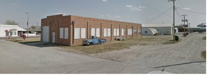

I bought this old building in a small mostly run down town which started life in 1949 as a Chrysler/Plymouth dealership. Over the years a lot of different businesses have moved in and out and then it just got dilapidated. The structure is very good and I did get the roof redone but there is no electrical, power, hvac, etc.. The building is mostly for storing my project cars and working on them off and on when I have time.
Everything needs redone with state inspections before any power or water can be turned on. The problem is that I can hardly find anyone to come work on it and if they do show up want a small fortune to fix it. I paid very little for the building and I am not that interested in dropping another 40k into getting the utilities back on.
The question I am looking for suggestions.....as a weekend warrior/shade tree mechanic....I am thinking of treating my shop like a job site with portable power. I need suggestions on what sort of job site setup I should be looking for. How big of a generator to run a 220 welder or air compressor? Gas or propane generator? Should I find a gas air compressor? Heat source for the winter that is efficient. etc etc
I really want to plan this out so I am not buying random equipment and have a good plan on making this a job site that is fairly permanent. Like an off-gird type of set up almost.
Some pics of the building....and it is a cool building I would to eventually fully restore. Thanks for any suggestions on making this a functioning work shop.

I'd do a complete survey of what will be required for you to occupy the building before I did anything else. You may even be able to identify steps of renovation that you could take as a planned incremental project.
It might go like - start with basic power and water, (panel and meters) then go from there in steps. A permitted job that takes a couple of years to complete., if the city and county permit such. I might even call it something like saving the town's history.

@mike93lx I do use a lot of battery run tools now. Just have to pack them back and forth. I am also exploring some solar options in order to leave the battery chargers behind and have limite solar power when I am not there.
@Hank11 I have explored several restoration options with the city and state. There are programs but require the money to be used towards opening or starting a business. Long term I will eventually get it back on the grid and fully functional but in the short term would like to make it more functional without packing everything back and forth and also being able to run the welder and so on.

@Copymutt The RV or camper idea is definitely being explored. I am roughly 3 hours from the building so I go for the weekend to work on stuff. Also looking at building a bunk room and putting in a wood burning cook stove.
@inphx Its in the middle of Nebraska. My big concern is hail with solar panels outside. I am exploring if I can put solar panels behind all those west facing windows.

@jack stand it was never condemned and passed environmental survey inspection. The city really wants a functioning business in it although half the buildings in town are empty. The end goal is to restore but could be years away.....I would like to get some near term solutions to get some work done in it. Power is the biggest problem...even to work on the building itself.

@stingry been to Morrill many times.....lots of old cool buildings in that town as well. Its also not quite as defunct.
What exactly is the problem getting the power company to just energize the building?
You said that it has had several recent businesses in there that must have had power to operate.
I don't know the last time a functioning business was in it. Mostly abandoned for at least 10 years. The power company came out and told me they wont even attempt to turn it on until all new power is brought from the pole to the building, and all new panels were installed, etc. All must be state certified.

If you are going to permanently occupy the space, get it up to code and get the utilities back on.
An off-grid setup to support a larger welder and compressor is a major chunk of change that could be used for other upgrades and maintenance.
A bobcat or ranger and a gas compressor would be my temporary fix.

As for electric, I'd repair the main panel if it was damaged, make the minimum outlet branch and minimum lights.
In my county it's one light circuit and one GFCI outlet and one light on the building exterior.
I guess you'd need to check the HVAC circuit as well.
In the counties I live in anyone can repair their building, the power company may require an AHJ(county)inspection to reconnect.
When I ran electrical to my barn, the PoCo and county were really helpful and gave me great advice for doing it myself.
Have you talked to either of them?
Tell them what your trying to accomplish and I'm sure they will help.
As for plumbing checks without water, I'd start visually inspecting the supply side starting from the meter and maybe run some air listening for leaks. Then I'd figure out the sewage after that.
I think there is a lot you can do yourself that will get you going.

I suspect that the issue is that it’s a commercial building, which has different rules than a owner owner occupied building.
A friend of mine bailed on a somewhat related project because, even as a licensed general contractor, he wasn’t able to rehab a fire damaged building without hiring licensed plumbing, heating, and electrical contractors. He could do the carpentry, but that’s it. It may have been complicated by the fact it was an apartment building, though.
As it was, the project didn’t pencil out.
From my own experience, a licensed electrician had to be present for the power company to reconnect a main panel we relocated. I did all the work. Paid $60 for him to watch.

There is a portion that used to be a paint booth and wash bay which someone combined. Probably about 24x24.....could be a good place for something like that.
