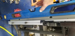

So the saw showed up and it has some issue, the table is not flat, the "wings" ? are about 1/16-1/8" lower on the end then the middle of the table.. tested with a few straight edges. Also the fence was a little dinged up and not aligned properly.
Amazon is sending me a replacement, how flat can I expect the table top to be? And how much would that affect my cuts be true? I know its not a $5000 saw, but its should be good quality for the money feel.

here it is table looks to be total flat, the composite table will scratch over time
the level doesnt rock at all if you press down on one side? I just got the 2nd one in the mail and same thing as the first

your throat plate is not sticking up is it ?///
no its pretty much level, maybe a little low.. still have the same problem if i measure not near the plate
I went to home depot & checked out some of the table saws they had.. ryobi was similar issue with flatness.. one of the ridgids was near perfect flatness & so was the bosch.. the smaller dewalt model they had also was not flat

I have seen even unisaw and heard about pm66 with potato chip tops, not that it's the norm for them. Maybe a good reason to buy local armed with a straight edge.

Are these single piece tables or three piece with two wings?
If the latter it isn't uncommon for them to be flared up or down. I've shimmed these with masking tape.

heres a few pics showing how the table is not flat, seems almost like its raised in the middle section causing the straight edge to now lie flat.. ive tried this with several different rulers, level & combi squares.
Will this affect the cuts much? I dont know, but for 5-600 bucks i expect better, i could buy a cheap laminate countertop at lowes thats flatter than this
