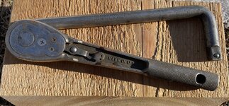

Some Blackhawk sockets (and a ratchet) I have been cleaning up today. Unusually for me, in SAE sizes,
Some ”food for thought” if you view 1/2” drive as something solely for larger fasteners.
This 7/16 socket is beautifully proportioned. Yes, I know in some circumstances you might want it slimmer, but in other circumstances these are lovely to use.
The square drive will never be a point of failure.
And the standard length ratchet handle has more than enough leverage to comfortably move even a rusted fastener, of common size.
Admittedly in this case, it’s Blackhawks faultless “Free Wheeling Ratchet” incorporating a sprag clutch. Probably the best ”ratchet” ever made, and decades ahead of it’s time, like so much Blackhawk. This one still works flawlessly, despite being circa 80 years old.
And of course these tools all incorporate Blackhawk’s push button ”Lock On” feature. Again, still working perfectly. I’m not convinced that our modern quick release ratchet’s are an improvement as these can be released so easily with one hand.

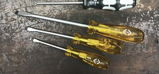

I have quite a few of their screwdrivers. Only for those who like green, but fortunately I do!
They make a lot of the better quality screwdrivers for third parties too - companies such as Bernstein, the electrical supplier, so if you don’t like green there are options…!
They also make the better screwdrivers for Carl Kammerling, a well known British distributor. I really like these and have a fair number.
I would have no hesitation in buying any Heyco tool, they are well made and nicely finished. Unfortunately, they are not heavily promoted, I think because so much of their output is sold under other names.
