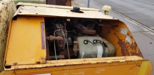

The compressor head on that one is completely different than the Gordon Smith design like mine.
