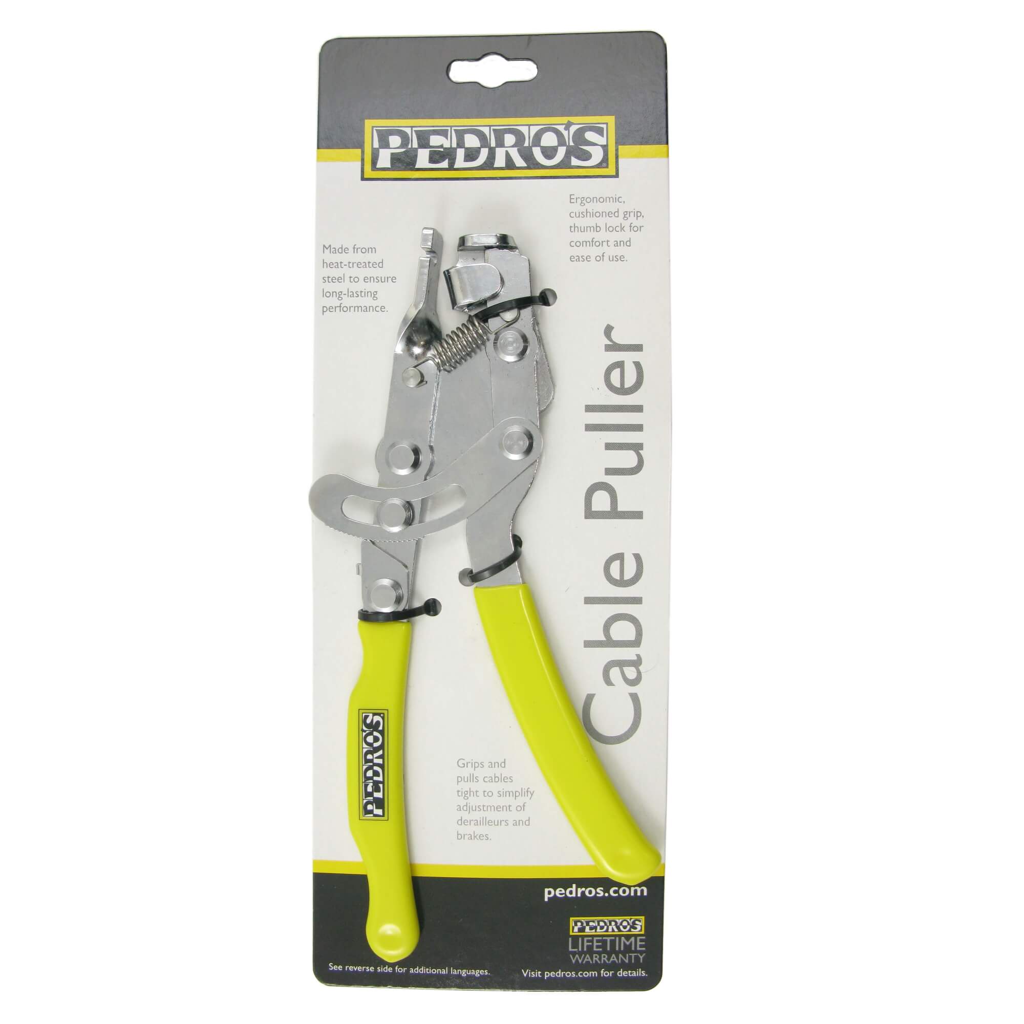

If you have quick clamps, the pistol grip kind, you can use those for third hand tools.
Don't forget fourth hand tools too.
I have one of those 4th hands and it works great but I am very glad I haven't had to use it in a lot of years. I honestly do not miss cable actuated brakes.
