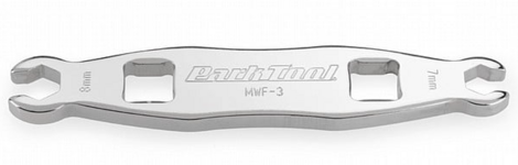

^Ironically I just realized I was missing inconveniently an 8mm flare out of the tool collection during my 1x di2 retrofit. Have at least 3-4 9mm options for some reason.
How does it compare to the park? It looks beefier. I am trying to figure out if the longer length of the park is an asset or liability.
Also considering a Tekton or proto crowsfoot flare.
I have a general disdain on Park tools, mostly because people think they are premium (mostly bike mechanics). However i can't speak about this wrench because i don't have it. I consider pedros a far better design and it's not a mile long either. That could be troublesome in some cases.
As for the tekton, its of course a real tool conpany, but I wouldn't buy a 3/8 inch drive for this application, where all is needed is 5-8nm of torque. I bought the pedros for 10€ which was a no brainer imo. Also, you wont find 8mm 1/4 drive flare nut crowfoots, from any brand exept for snapon
I tried the Tekton and the socket attachment is too close to the wrench end to work on a brake line, the ratchet head gets in the way. You have to use an extension to get on a nut, which seemed silly when there are better options.

You need 1/4 drive for this application
Yeah ive seen the nepros, but as you mentioned, not 6 sided. 12 sided exists also in stahlwille flavour. I bought the pedros and end of story
I’d go with just about anything over Park. They make very few tools these days that are not garbage.

Do you guys actually torque brake line compression nuts? I'm all for doing things the right way but I cinch 'em up with an open end and move on with life.
Odd-job
Aug 13, 2017
2,327
Going forward I am going to be torquing to spec. Having some seepage issues on one of my lines by the caliper because I haven't bought the right tool (yet).
Historically I was a good n tight type of guy, but the excitement of preventable mid ride issues is getting old now.
Also having a variety of torque wrenches helps the motivation. I realized I missed the boat on Tohnici beam type I have been lusting over. Not sure if its the tariffs and/or the exchange rates are impacting pricing.
YesIHaveAHammer
Jun 1, 2025
1,006
Yes.
If I cinched them up it might be ok, but I'd probably undertorque them - inviting potential issues. It's not a job I often do, so I don't have a learnt feel of deforming brass fittings to 8 Nm. Not the kind of thing you can fix up on the trail with most multitools either.
HannibalLecter
Aug 26, 2023
420
Usually no. If they are connected to a dura ace lever that is known to break, yes. The same goes for the sram red as well.
For mtb brakes that don't cost 500€ a pop and are all metal, no
