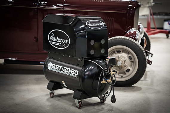

A few weeks back Matt at Eastwood called and asked if I would be interested in testing one of their new scroll compressors in the shop. I've never "reviewed" a compress...

If that 69 dB rating at 1 m is true
I don't have anything to measure it with... but you can easily stand right next to this thing with your pant leg touching the tank and have a whisper conversation with someone a foot from you. Easily. It's really, really quiet.

Two of the most problematic uses for any compressor are spray painting and sand blasting. Heat added to the incoming compressed air adds or absorbs more moisture to your compressed air supply. When i am spraying anything by the end of my project i am usually seeing moisture in the air lines even with multiple absorbers in line and at the spray gun. If you look through the many GJ threads on this subject, you will find that those problems are tackled with varying amounts of success by the members here. Does the scroll compressor improve this problem?
I have no idea... Maybe Matt at Eastwood could answer your question.
I did, however, use it on the sand blaster for a bit... and it ruled. Even with the tank depleted, the compressor did a great job keeping up with it... and I never noticed much condensation. So, there's that.

It is quieter than most, but I see Eastwood did some movie magic to their videos.... It seems like they shot the video from miles away with the camera zoomed in to get that scroll compressor seemly running at no noise at all. maybe.. the noise difference between the two video is apparent...
Having used the compressor, I can say that video represents the difference between a typical piston driven compressor and the QST accurately. I mean, I can't say this enough. IT IS REALLY QUIET.
And again, I have no motive to exaggerate that claim. These people haven't paid me and there was no expectation for me to give this thing glowing reviews. I'm sure if you tried hard enough, you could find a reason to bag on this thing... But sound level is not gonna be one of them.
What size/specs is the blaster?
This is the blaster I was using:
http://www.tptools.com/USA-SKAT-CAT-46-Abrasive-Blast-Cabinet,8892.html?b=d*41308
The last time I used this blaster it was hooked up to my monster Champion VR5-8. The QST didn't keep up with the blaster as long as the Champion does, but it did surprising well... and because you can't hear it over the blaster, it made blasting more enjoyable for sure.

I appreciate the review. I was surprised to hear just how loud the compressor was in the video. To be able to hear the background worker, his music, the guy talking, and then hearing the compressor get flipped on, subjectively, that doesn't sound a night and day difference more quiet than my compressor, a California Air Tools type pump. It certainly didn't sound anywhere near as quiet as the marketing video makes it out to be. I guess there really will be know way to know just how loud it is unless you hear it in person. What sounds loud to me, other may barely notice.
Again, I don't know how to quantify it but this thing is the quietest compressor I've ever been around. The best example of it I can think of is a typical air conditioner... Like right now I have no idea if mine is running because I'm not thinking about it. That's sort of how I feel about this compressor.
Another way to say it... It's produces about the same level of sound as my drill press.
There is no comparing it to any piston driven compressor I've ever heard. I'd bet my pink slip it is way quieter than your piston compressor. You just need to hear one to judge for yourself I think.
If you are looking for an excuse to pass on this one, chose something other than sound level. Seriously. It's quiet. I don't know how else to say it...
Sorry to keep asking question but that's the kind of set-up I'd like to get eventually. Do you remember how long did you go before you were out? Are talking a minute? 5, 10, 15? It's been hard to get some actual idea of what it's capable of in the reviews so far.
I should have taken note... I don't do a lot of reviews because I'm not all that good at them and this is a great example of that.
It's hard to say how long I blasted until the compressor turned on simply because I couldn't hear it kick on. I'd guess I blasted well past 10 minutes though before I noticed the pressure backing off and stopped to let the compressor catch up.

The compressor weighs 325 pounds and is designed to be extremely stable with the horizontal tank and casters on each corner.
Anyone planning on hooking this up to a bigger tank? Is it needed? does the compressor really do the job of a 60gal? I have a true 5HP 60gal with a 2 stage pump that puts out 17CFM@90PSI and it is overkill for what I use but this air compressor on paper would struggle with quite a few HVLP guns. Seems like it all comes down to noise with somewhat decent air output.
We did hook this same machine up to a couple local professional shop's air systems and shut their compressors off. The QST kept up with multi-tech shops all day no problem. If you require additional air reserve you could do that and with the recovery of the compressor being so quick in most cases it would do just fine, but it of course has limitations. This compressor was designed to be used in a home garage or small shop with 1-2 people working off of it at a time, but we wanted to torture test it.
We have a video linked below where Mike Phillips of Phillips Hot Rods and Customs explains his test results of running it in his 12,000sq.ft with 2" hard line running around the perimeter.

CGT80
Aug 29, 2014
897
IE, SoCal, USA
I have a skat blast cabinet as well, TL780. The size of the nozzle determines flow, a small nozzle I think is in the 5-10 cfm range, med 10-15 cfm, large 20-25 cfm at 90 psi. There are a lot of nice features with this compressor but the tank size is a concern. As mentioned there is the concern with a new product, will it last, will the price change as competitors copy it, will a larger size be offered that may suit more applications? Do I buy this now only to see say a 18 - 25 cfm machine come out next year?
I have been looking and was very close to the Emax 5 hp 2 stage 60 gallon silent air machine with about 17 CFM so it would be interesting to see these side by side for the low noise title!
I use the large nozzle on my skat gun, in a HF cabinet that I have improved. My compressor is rated at 17.4 cfm at 175 psi and based on fill time to certain pressures, it is averaging 20 cfm. It is set to start at 140 psi and shut off at about 175 psi and it takes one minute to run that cycle on an 80 gallon tank.
With that large blast nozzle, it will catch up and shut off for a minute or two, easily. This is at 100psi, after the 0.01 micron motorguard filter. My pump could be running slightly faster than the 800 rpm in the decades old spec sheet.
12 cfm certainly would not take care of my needs, where I have my big compressor located. For the other shop, with the plasma table, it could be enough, if the pressure stays high enough after the filters. It sounds like this eastwood unit will max out at 140 psi, but how low does it drop before it runs again? The cman 5hp advertised compressor starts up between 100 and 110 psi. Under 110 psi is no good as the pressure drops at the plasma. With my big compressor, I run over 100' of 1/4" hose, but it never drops below 140 psi and there are no problems.
80 gallons at 140-175 psi is a lot of reserve, although I may upgrade to a 120 gallon tank as the pump would run less often and it would only add 30 seconds to the run time. This week, I changed the bearings in the motor and replaced the start switch and mounted the tank on cast iron castors. It is even quieter......chug, chug, chug.
30 gallons at 140 psi max is much less reserve and then there is only a 12 cfm pump to feed it.
I agree that the current eastwood scroll is small for a serious home/small business shop, but if it proves to be reliable it may fill some needs. It would certainly beat that obnoxious cman we are using. For now, I have my eye on an old cast iron pump similar to my big compressor. It may be an inexpensive way to get a more tolerable small compressor to replace the cman.
