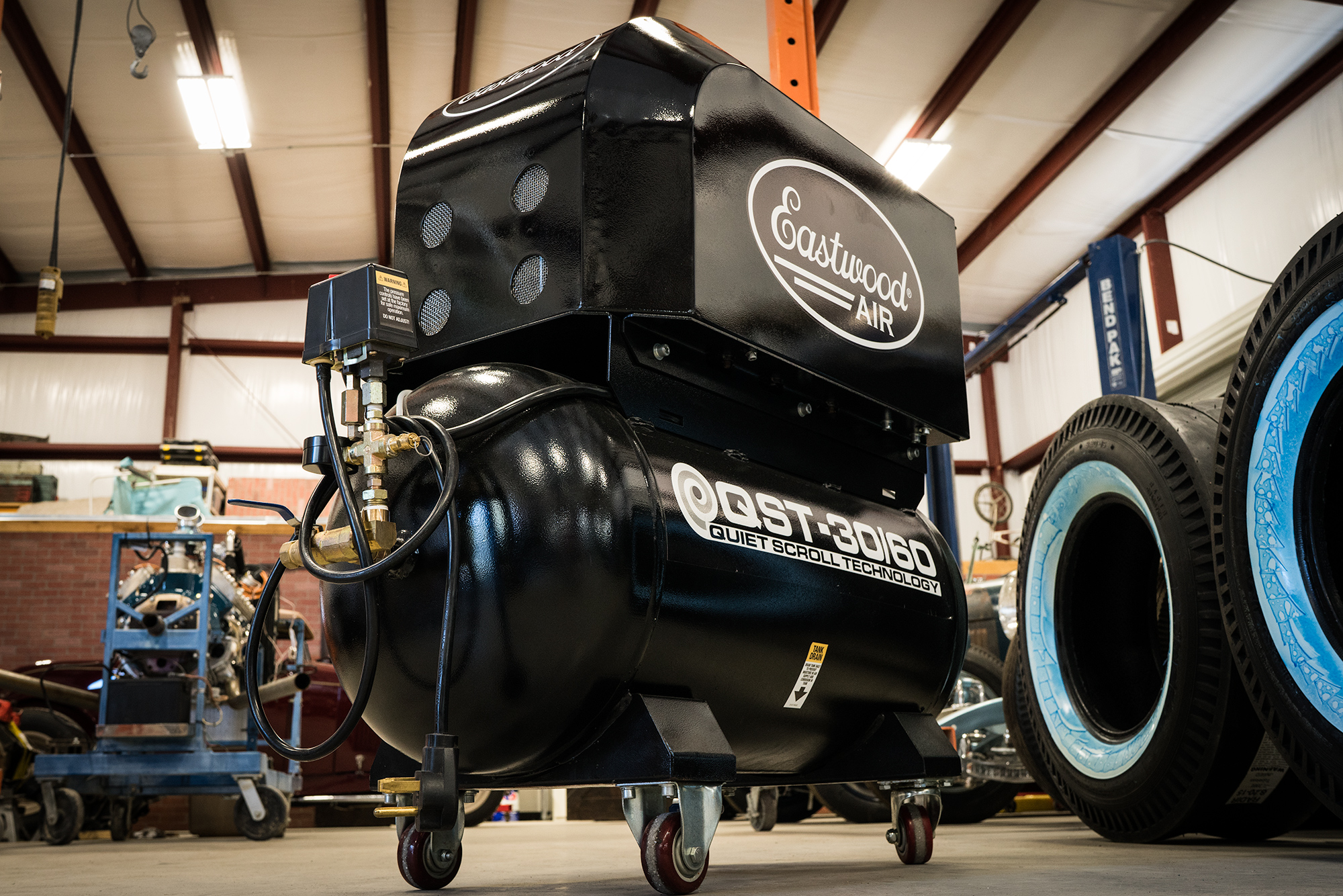

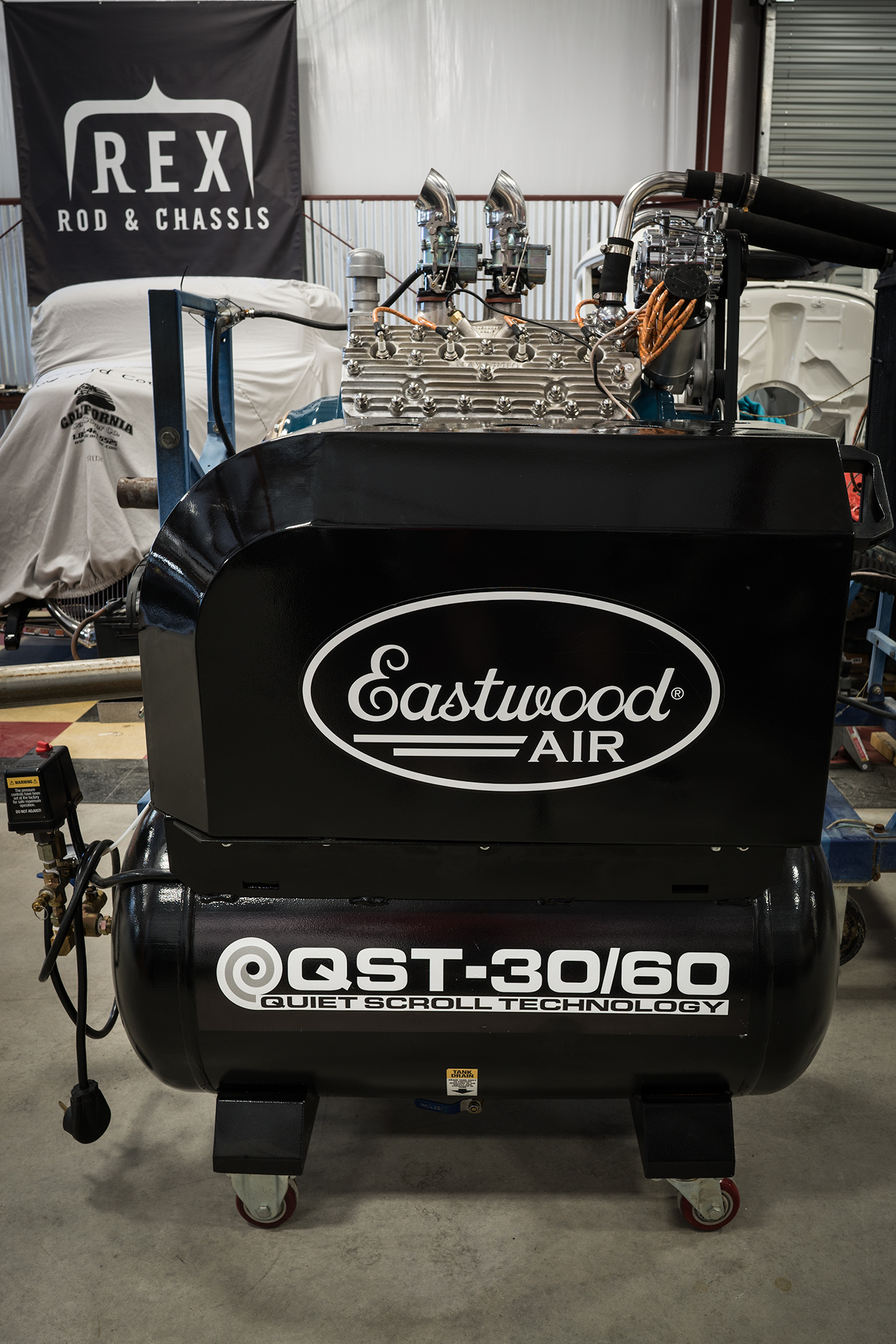

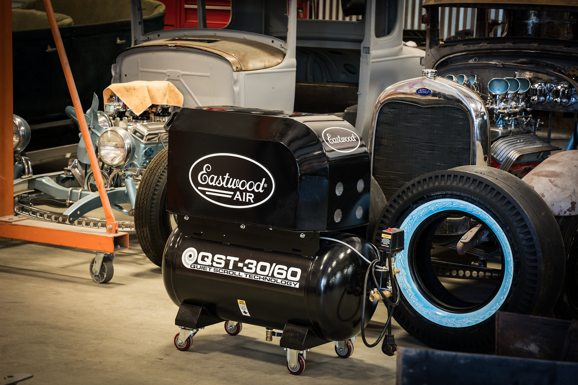

Mobility
The unit Eastwood shipped us was a prototype and one that we had to ship back. As such, Keith didn’t want to hardwire or plumb the compressor into his shop for the time being. Instead, we put a plug on the unit’s cord and then used the compressor as a mobile station that could be rolled from job site to job site within the shop.

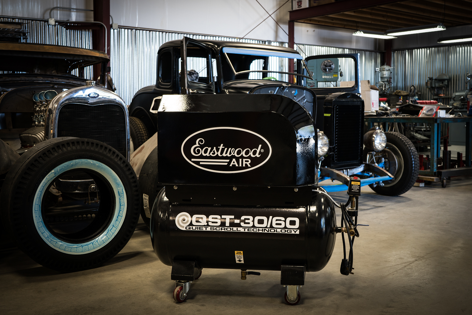

The QST-30/60 seems to be built for this application. Rather than a pair of cheap wobbly casters found on most mobile compressors, the Eastwood unit has a pair of heavy duty swivel casters on one end and a pair of fixed on the other. These combined with the push handles on the compressor itself makes this thing entirely more mobile than you would expect for something of it’s size – 44″ wide by 39″ tall by 21″ deep.
So basically, Keith and the fellas would roll the thing over to a work area, get to work and then put it away when finished. And while this might seem like a pain in the ***, it was actually kind of handy if you weren’t moving around too much. Of course, like any other compressor, the unit could be hard wired and plumbed into your shop as well.

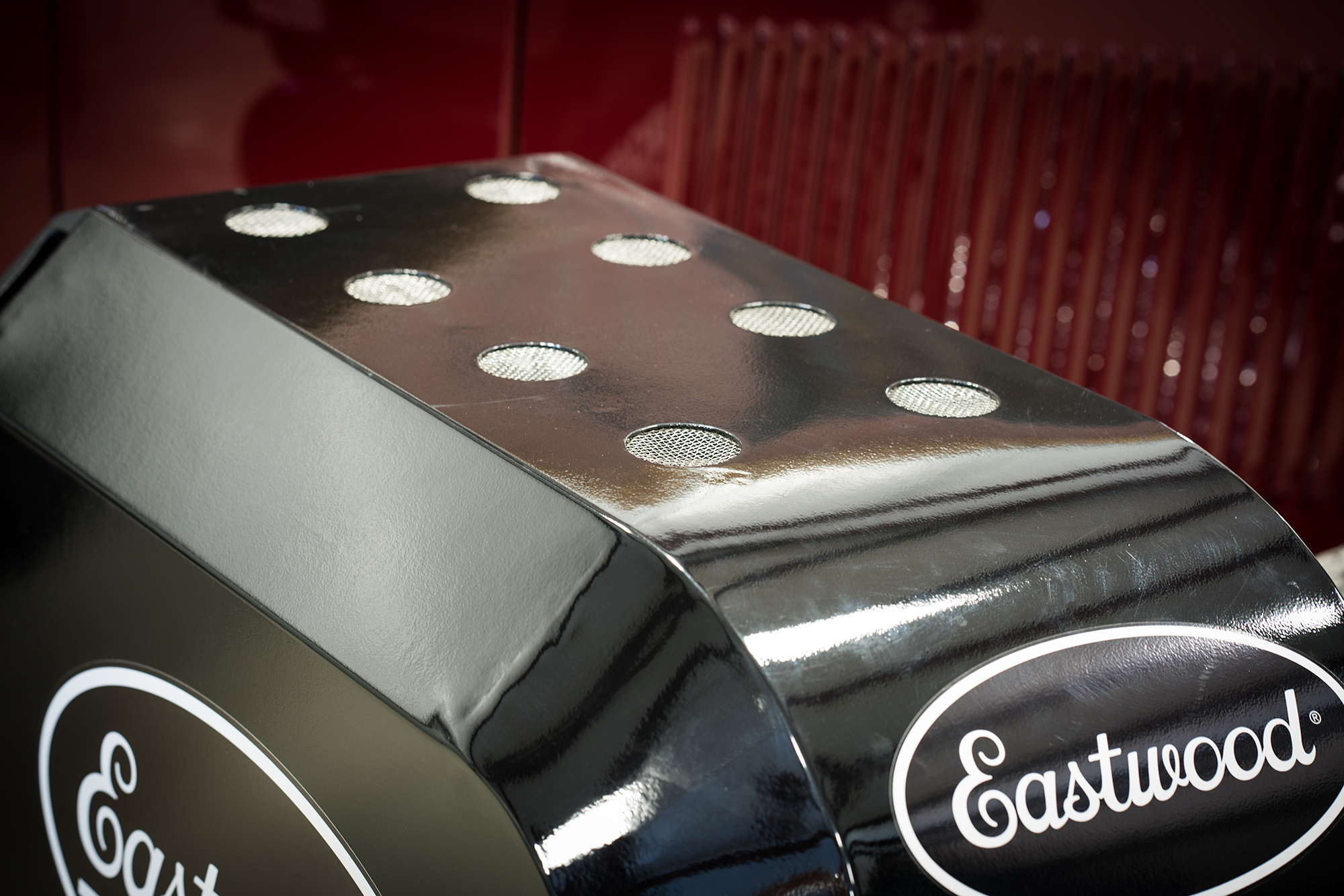

There’s very little plastic on the QST-30/60. The pump and motor are shrouded by a really slick and nicely formed piece of steel. The tank is nicely painted and all of the fittings are placed where you expect them to be.
To put it bluntly, it’s built like a brick **** house and feels like it. There’s just no comparing it to a typical 30-gallon compressor on any level. Plus, it just looks cool…

The other way the QST manages to punch above it’s weight class is by way of noise reduction. Few things are more annoying in the shop than a compressor running on the reg and when you only have a 30-gallon tank, that’s inevitably gonna happen. But the QST is so damned quiet, I found myself not caring if it was running or not. Here’s a quick video demonstration with typical shop background noise:
And here’s Eastwood’s own marketing video comparing the noise to a typical compressor:
Essentially, the QST sounds a lot like an air conditioner kicking on. If you listen for it, you can hear it… But if you aren’t really concentrating on it, you don’t really know it’s running. It’s that quiet – almost eerily so…
