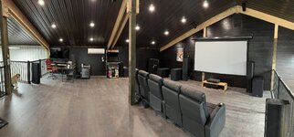

I put together this AV rack for the theater equipment and a similar one for the server, network switches, surveillance, and backup power supplies.
A couple of black friday deals here to keep up with the industrial look.
Here I started staging where I'm going to put the AV equipment. The wood console is hand built off of an Etsy console maker in California. The blue tape represents the 130 inch motorized screen that will be rolled up when not in use to keep down on the dust and supervisor paw prints. The big boxes are the subwoofers. ;)
These are the theater seats that are staged with 2 more subwoofers. The Styrofoam piece marks the primary seat. At the back of the room are 2 more speakers. I'm going to have to add more wiring for those. At the last minute I decided to make it a 7 speaker surround with 4 Atmos and 4 subwoofers. I'm actually going to attempt to pressurize the building with enough subs. If it doesn't work, I'll just make them near field so the seated people can at least hear the intended rumbles. I was going to have some economical seats built by a seating manufacturer when I stumbled upon these Valencia seats of higher construction quality already built and ready to ship. I guess the company had built them for someone else and the potential owner decided to not to take possession. So, I got brand new motorized seats at over $1,000 off with shipping and liftgate service included.

Wow, you have really been stress testing your new digs huh. Well the media area is looking great! My brother actually works for a flooring company let me reach out and see if he has any recomendations for what you set up.
also...... pictures like this is why I live in the south! Snow is pretty and I like to look at it, no interest in being in it though haha

Its funny how you had to use the security camera to get a photo of yourself doing what you say you were doing. I find that I have the same issue, always a photo of what's being done, but not of who is doing it.
It was difficult to find a screenshot where I wasn't blurry. I'm not one to sit in one spot for very long. I'm trying to catch Sasquatch for the hide and seek champion of the Pacific Northwest.
the floor looks spectacular btw. ties the whole thing together very nicely.
Thanks Black. The shop floors came out good also. That will be in the next post.
