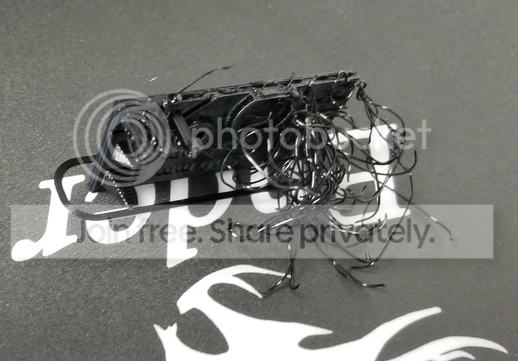

I started the "All in one 3D print" My first one from the slicer. I am using Cura. As you can see, I did not rotate it correctly first. For printing on its side, I don't think it looks too bad. Or is it kinda like the saying "A face only a mother can love" :)
I posted a short video of trying to print in mid-air:lol_hitti.
penright
Dec 27, 2016
618
SW of Mustang, OK
Next time I will try and take better pictures. It seems to work better when the right side is up.
These settings are right out of the box using Cura slicer.
Thoughts?

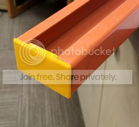

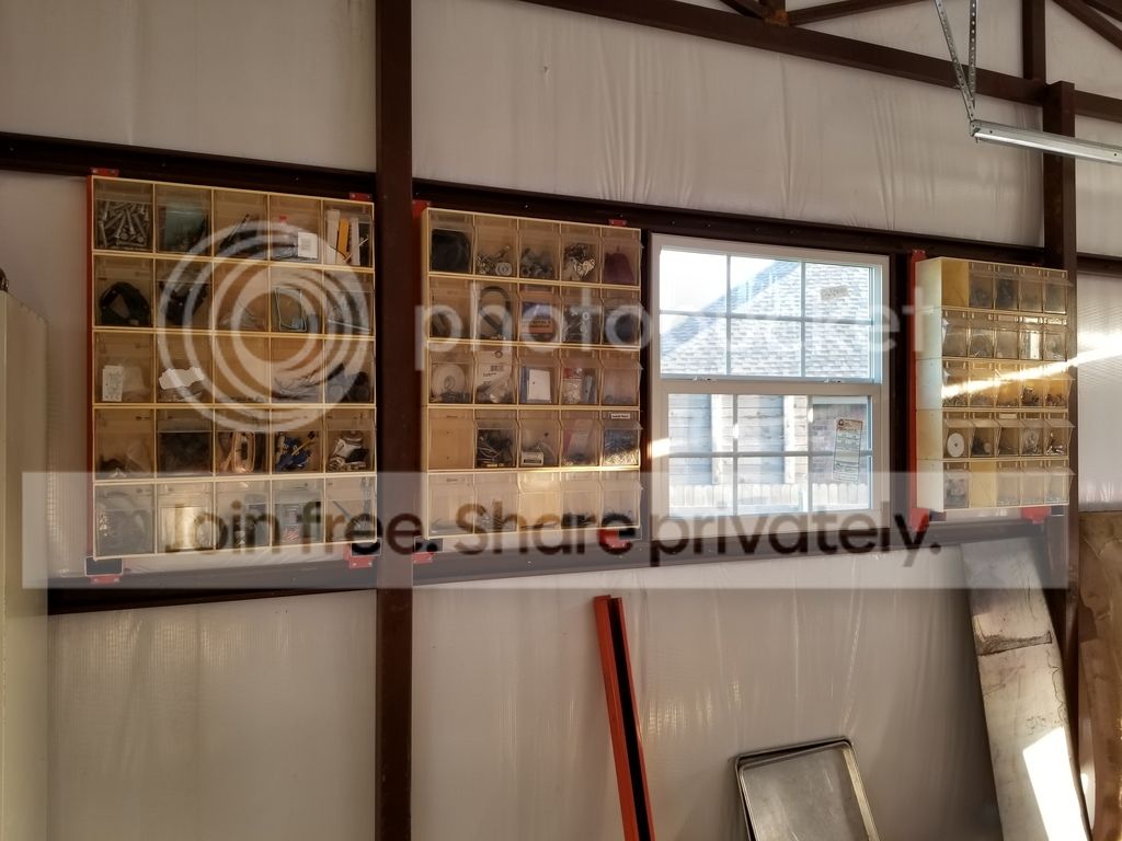

Printed my first useful item. Well, I think it is useful. Also, I went through a few attempts. I did it from scratch in Fusion 360.
I mention in the previous post that I use this c-channel to hang some storage bins. The very bottom piece holds creates a little shelf for the bins to sit on, so the screws in the back do not hold all the weight.
Anyway, the end being opened looked kind of unfinished. I tried to google an end cap but nothing in the right size.
The first picture is a piece of scrap I used to test the prints. The bottom picture is where they are going to go. Few more to print. :)

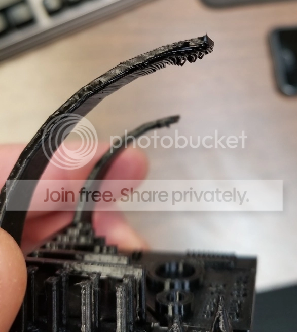

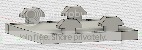

I am pretty sure my problem is supports. My question how do you support such a small overhang?
First, this is what I was trying to print.
This this result
A little context and scale. Take a look at this part ...
I included the Exacto knife for scale. This will actually fit in a 40 x 40 aluminum extrusion. So my next step is to add the base. Once I have that sized right, I will use it to attach the octopi camera.
I wonder if there is enough room for me to add support? Plus I don't know what shape the camera holding part will look like. This is more of a learning experience right now than practical.

You could always print it in three parts. The two ends laying on their sides an the flat slab connecting them and use model glue to assemble the parts.
