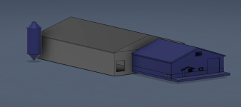

i wonder if this could work...
In your climate I expect the bulk pellet storage works best if it's kept inside and away from the temp swings. Been in a couple injection mold shops and they all kept raw pellets indoors to make processing as consistent as possible. Assuming they're coming in a probag or similar setup like we can get seed in....heavy duty large bag with lifting hooks on the top and a draw close chute in the bottom. Build a basic steel stand over a small conveyor or flex auger system to empty the bag then use the auger/conveyor to fill an internal hopper/bin. Saves you 6' of headroom height vs trying to fill a tall bin or hopper direct from the bag which then has to be hoisted above the bin/hopper opening
super sacs just cost more to transport is all. What we can do is go over the machine with hoppers since they only need 6' head room.
Worked for an injection molder for a little bit. We used hopper loaders and pulled from dryers or gaylords. Saves a lot of height and were automated. Just needed to shove the nozzle in, turn on it on, and come back when pellets were getting low to swap out.
raw -> dryer -> machine surge hopper. air transfer system.
This is to feed the filament production line, correct? Or is there a possibility of pellet feeding the printers?
Either way pneumatic conveying is the way to go as long as you go with a solution that has a reasonable noise level.
