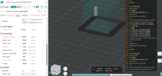

I am switching over to Orca splicer due to the fact that I am going to get another printer to try and might as well be familar with it. I like it in some ways better than Cura that I have always used.
I have everything running but I have one issue that I am tearing what little hair I have left out.
I can set my outer wall speeds higher (and acceleration) and no matter what, it wont change the speeds? It runs at have the speed of the base layer even though the speed numbers are higher, the acceleration is higher, and even the (F) feed numbers in the Gcode is higher? The limits in the machine ability tab are 20000 acceleration, well above what I am trying to run (6000)
Any Ideas what is throttling it back so much?
Feeds
Base/brim
Outer wall

Acceleration is limited by the torque of the motors. That may be a function of the design of the motors, or it may be the controller’s current handling ability, or the controller’s ability to rapidly generate steps. It doesn't matter what numbers you put in slicer, if the controller can only do one amp, you are only going to get so much force and so much acceleration. Acceleration can also be limited if there is two much drag on the system. You only get so much force and any used to overcome resistance, reduces acceleration.
Normally you don’t hit the physical capability limits, you hit the limit of the controller to be able to process the kinematics and react appropriately. You end up with overshoot and ringing because the system can't deal with the momentum of all the mass at the head.
For speed, there are a couple of reasons. You may not be able to reach the top speed due to the acceleration. There is also a max flow rate setting in the material settings tab. It is a function of the material, nozzle diameter, and heater capacity. Slicer will never let you move faster than you can deposit material. Simple analogy, a brick layer may be capable and asked to lay 5 bricks a minute. However, if his helper is only delivering one brick a minute. His moving down the line without material is a waste of time, energy, and leave gaps in the wall. As a result, the fastest he is ever going to go is one brick a minute.

Its something in the slicer. I have the same speed, accel, and jerk values in cura and it doesn't throttle it back. Moving to a larger model runs the right speed. I need to dig into it but there appears to be some minimum layer time or something holding it back, I didn't expect a 20mm x 20mm cube to be throttled back like that.
I am having issues still with making crappy lifting corners in ORCA however, although much of the other features have slightly better surface finish compared to the same part in CURA

I didn't pay attention to how small your part was. Min layer time would absolutely also do it. Time=Distance/Speed. Slicer is going to slow everything down to make it work.
I think Slic3r which Orca, Prusa, and Bambu are based on does a better job with mathing then Cura and as a result does a better job holding all the constraints resulting in better part. By default Cura skips come of the calcs. As a result it can be much fast on big parts, but I have had problems with it not enforcing the flow rate correctly.
Another option for speed problems in Orca, is overrides. I'm more familiar with Bambu's layout, but you can set override based on filament for just about every setting. If you have a speed or a flow rate overide, it will trump any other setting and limit you.

Not in front of my computer right now but I believe the minimum layer time setting is in the filament/material setting. Switch to ABS and reslice and see what the print time estimate is
