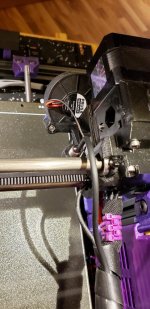

And here is my printer as it sits now.
I have all the replacement parts reprinted in the Devil Design Galaxy Violet PETG, but I haven't installed all of them yet. I have a couple more accessories and upgrades to print before I tear apart the extruder bundle to remove the original probe and swap the controller enclosure.
I want to make sure everything is printed before I tear it down again, just in case...
That said, I have been SUPER impressed with the Devil Design PETG filament. I've had much better prints with it than the eSun PETG and it's been less stringy than the Prusament PETG. I wish it was available here in the U.S. :sad: However, I am planning to order more hardware from RatRig, so I'll be adding several spools of DD filament to that order.
I have a few mods planned for my little cart the printer is on. I'm going to build an insulated enclosure for the top and mount my power strip to the cart. I'm planning to integrate a vent with 4" fan into the enclosure so I can vent the fumes from ABS out of the house through a foundation vent I have under my kitchen crawlspace. When I want to print ABS, I'll have to wheel the cart into my hobby work area and hook up to the vent, but that will keep the awful fumes out of the house.
I'm also going to add a large dry box on the middle shelf to store my open filaments. The lowest shelf will store unopened boxes.
