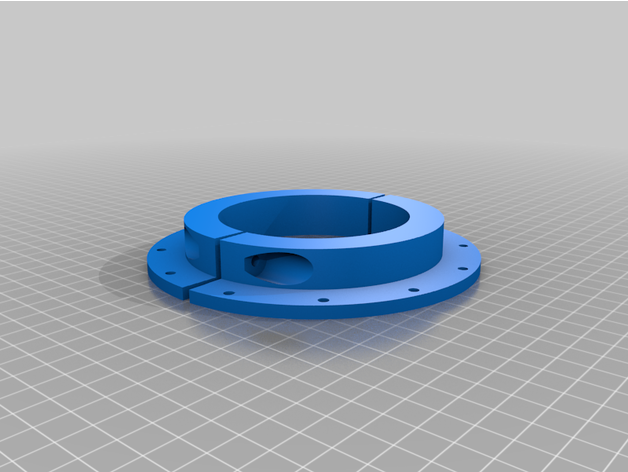

Made a tone wheel for a friend's 240Z. He's running an 800HP 2JZGTE in it, and wants to calculate the slip between front and rear axles. It's printed in ABS, has 12 triggers, and gets read by a hall effect sensor that bolts up to the old dust shield. It clamps around the hub, which is mechanically separate from the brake rotor, so it shouldn't see much heat (if any).
I made it parameterized so that I can resize it or otherwise adjust it for different shafts, different numbers of triggers, and different hardware, but this seems to work the best for the guys that wanted them.
I'll never have an 800HP 240Z, but at least I'll have some parts on one :p
