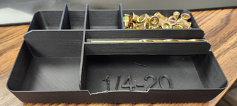

Just created a new storage trick. It is based on Dollar Generals' school, pencil cases. They are cheap, like $1 apiece. They have a design on the top to lock in for stacking proposes. The basic design is a shell that fits the case, it can be really thin since the case does all the work. Designed in dividers for whatever. Once you have the shell, you can use it over and over just changing the layout of the dividers. My first try was for my 1/4-20 rivet nuts. I wanted to store the right drill bit, then I left room for a few bolts, then a spot for some nuts and washers.
I did it in fusion 360. This is the first try, I need to tweak the roundness of the top at the edge and put a notch to clear some tabs on the front that hold the lid between the latch and back edge. I did the tweaks with some clippers. :) The print was 11 1/2 hours on my Ender 3, so I am not going to reprint it. :) I will share with anyone who uses Fusion 360.
Not sure why the 1/4 emboss messed up.
Working out the size with partial prints.

cool idea. I'd probably make some space for helicoils and the accompanying stuff too, so you've got all the tools in one spot per size.
penright
Dec 27, 2016
618
SW of Mustang, OK
That is the cool thing, you can model it to whatever you have room for. You just have to remember the size is only about 4"ish x 6"ish.

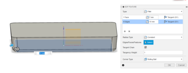

The solid is 31mm with a 5 deg taper. This gets the block and the bottom.
These are the roll edges to get it the final fit for the bottom.

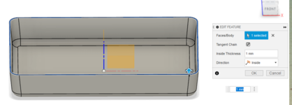

Then shell it out to 1mm. That is almost the basic shell. It does not have the reliefs for the middle tabs.
