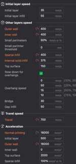

i'm slowly putting all my printers to the .6 CHT nozzle. this takes it from 2 walls to single .8mm wall thickness thus dropping print time pretty dramatically.
each printer then is able to do 2kg a day that way. 4 production printers. 8kg a day at full capacity burn rate. a month and change on time. which sadly turns in ordering the next order before the prior one arrives. I need to up my order to get 60-90 days to better capacity planning capabilities. right now its guess work.
i need to do a new volume test to see if i can eek more out. between the below two is how it can pump thru so much in a time period.

fuzzy skin is .2 / .08 now. with the acceleration numbers like that lets find out.
so this is the normal production print with my production settings.

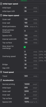

reseting back to factory on speeds BUT keeping the volumetric flow at 36:
Going to generic PETG profile from bambu and factory speeds:
If we go from a .6 nozzle single wall to a .4 nozzle dual wall at .32 height at factory everything with bambu default PETG profile:
so for me these nozzles make my machines 4x more efficient. I'm running into the limit of the heater on the nozzle. 400mms/36volume is about all the heater can do. I print at 242-250.
So the first example is with fuzzy skin turned off and it only decreased print time by 8 minutes? I've messed around with it in the past and it added a surprising amount of time to those prints. You've done some neat work maximizing print efficiency as you say. What's stopping you from going to a .8mm nozzle? Not enough detail or is it not able to flow enough plastic to beat the .6mm?
i might have grabbed a different printers print jobs. i'd have to dig in deeper. if they are within 15 minutes im happy.
I'm already at the limits of what the factory heater block can do. I'd like to keep it there and not risk the onboard electronics. it would also provide excess line width size for infill and single walls. I think .6 is the right balance.

Fuzzy skin on for 400s/36/.6
fuzzy skin off:
about an hour extra for the texture.
going to contour only:
if i change to .1/.1 fuzzy settings which is about the most i've ever done:
.2/.1
I dont really gain much. right under 8 hours is good as it lets them be efficient and minimal down time. I wish I could have some kinda ERM platform telling me efficiency of my prints. i'd guess on avg I get 21 hours a day per printer overall.

I've found with all the things working together it to be more of an impact. esp th accelerations from experimenting IMO.
different part: left side of that 2 piece actually.
fuzzy skin; .6 fast speed, 36 cubic
same part without the fast speeds/accelerations/ etc.

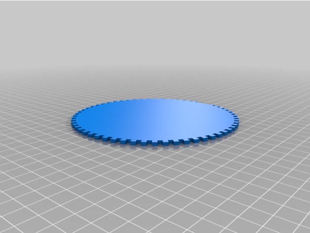

Making parts for my Audi project. I'm prototyping a 60-2 trigger wheel to bolt to my harmonic balancer. For a little extra effort, I parameterized it so that anyone can change the number of teeth, the number of missing teeth, the diameter, and the thickness of the part.
My goal is to get it set up to bolt onto the harmonic balancer on my car, then send the STL off to send-cut-send and get a part back that just works.
Still have to cut out the middle for access to the crank bolt and put 6 slots in for some undercut M4 bolts to hold it to the harmonic balancer.
