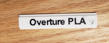

Any tips on what could be causing the black to end up on the top layer where white should be? It was printed in the same orientation as the photo. Bambu P1S with AMS. 20240917_110447.jpg

Can you look at your top layer in the preview window, does it start on the right side?
I'm curious if it's from an incomplete purge
This would be my first step. Do you have the purge tower on or are you purging into the infill? You can adjust the purge volume and when going from black to white may need to bump that up in order to prevent this (if that's what it is)

Currently travel is showing it leaving the print tower and going to the left side but the item isn't in the same location as it was when I printed it yesterday so your though could be correct.
Tower is on, not flushing into objects infill.
I am going to print it again and adjust the purge volume if needed.
Thank you both!
