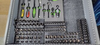

I think I finally finished my socket holders last night. I don't have anymore sets laying out that need a holder, and I can't find anymore loose parts that need placement. Mission complete! Here's one of the two drawers:
Nice! I just got done doing the same thing, was a pain to measure each socket with a caliper ;) What did you use to mark yours? Multicolor print? I used my Fiber laser to mark mine.

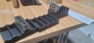

Holder for some 1 2 3 blocks
Far right version was the file from online but standing up they were too tall. Middle print was after scaling down the height and stretching it out in the slicer... But didn't stretch enough.
Far left was after adding another 2mm... Fits nice and have a home for 2 more when I buy them
Link for original:
Printed in matte PLA
