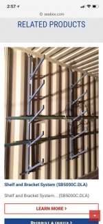

Interesting build. Using the storage containers has me thinking.
If you have access to a plasma cutter or the like you can easily cut doors in the sides too. Hard to beat the bang/buck for a container for sqft and security. I couldn’t have built a comparable framed structure for $3500, so it was a no brainer.

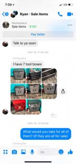

So I found a deal.... for me its a significant deal, and gives me the opportunity to do something really cool.
I found a tattoo shop going out of business, and they had been using some gladiator cabinets and toolboxes for working area cabinets. They were selling 5 x Gladiator 1 Drawer + Cabinet, 1 x Craftsman 5-Drawer Toolbox, and 1 x Random 2 - Drawer Toolbox (ignore this one for now) - got everything for $500 and of course they are all in like-new condition more or less, stoked!
I already had, and use 1 x Gladiator 1 Drawer + Cabinet & 1 x Craftsman 5-Drawer Toolbox. So, my totals are as follows:
6 - Gladiator 1 Drawer + Cabinet
2 - Craftsman 5-Drawer

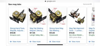

This is what I hope to do for the worktop... I have a bunch of the tabbed plastic hardware boxes, so you can see how I plan to implement the usage of those within the backsplash. I wanted a high backsplash because once these are in place, getting behind them to clean is not going to be easy.. need to keep the mess on the surfaces. I don't have a brake nearly large enough so I'm going to have a local shop bend this up. I have two pieces of mirrored, 4x10' stainless steel that were BURIED on my property when I purchased it, going to use those for the final layer of the work worktops, with 1 layer of 3/4 birch marine ply and 1 layer of 3/4 MDF sandwiched underneath. I'm hoping that gives some good absorption and solidity.
The way they're designed is actually quite efficient, my local metal supplier sells 20' lengths. For one bench the cut list looks like this:
2 - 20' (2 @ 54", 2 @ 56")
2 - 20' (3 @ 41", 6 @ 16")
Each bench leaves 1" cutoff waste, I can live with that. Still at the planning stages obviously, but I'm liking the way this will turn out so far.

Nice setup, how do the containers do with the humidity? Also more info on the mag tabs please.
I originally saw these on weldingtipsandtricks.com and I ended up using an amazon gift card to pick one up. Had I known it would be so useful I would have done it sooner!
They are really just some small neodium magnets
Weldingtipsandtricks also has a YouTube channel, and admittedly I am self taught from YouTube for the most part, but he has all kinds of easy stuff that makes life much easier when getting into it.

So now I feel like I’m falling down the rabbit hole....
All of that 1x1 stock I got from the remnant pile could easily make a shelving system like this, and save me some significant room from the wood shelving I have now.
They hang from the hooks in the ceiling and rest against the walls as part of their support. I could have the whole area be floating shelves...
Damn internets.
