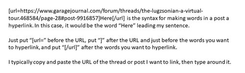

(I don't know how to make the word "this" become the link. That is a slick trick).
EDIT: Really having a hard time explaining it without it becoming a hyperlink, Tom. Sorry. I'll keep trying. Check back.
It doesn't match the image on the page above, showing 41 - H - 1508 with a knurled handle. Did Mossberg make knurled handled speeders, or did other makers fill that slot in the kit, or were the images simply inaccurate? Just curious.
Not all of the tools in that figure were provided by Mossberg, not even all the 1/2-inch drive tools. The hinge handle is OTC, for example, and the ratchet is New Britain. Wartime "GMTK's" were sourced from various suppliers, and the figures provided by the Ordnance Dept's Raritan Arsenal Publications Dept (RAPD) for manuals, including the GMTK manual, reflected that miscellaneous approach. Having said that, it is unknown whether that was intentional or haphazard of them. No one single OEM could provide all the tools in a GMTK, but the ORD could certainly populate a GMTK tool-set with most of the 1/2-inch drive tools from the same supplier (e.g., Duro, etc). The L-handle being a special and notable exception. Almost all of them likely came from Mossberg and Armstrong. That differs from modern GMTK's, which do come from only one or two conglomerate sources.
13,441
The way to make a single word link is to tap highlight the word THIS, then tap or click the two chink links left of the add a picture icon. A box will pop up, with THIS in the lower box. Paste your link in the upper box.
Should end up like THIS link, if it wasn’t acting up for me. Should have done the one above, not added it below
THIS
gearhead1960
Mar 21, 2019
1,932
@Mintgrun What you need to do is:
  1. Copy URL you want to link
  2. Type in word, in your case "this" where you want link to be.
  3. Highlight "this" and then left click on diagonal paper clip or infinity symbol above in header for your response.
  4. Paste URL into appropriate box from drop down when left clicking on symbol described in step 3. Click "Insert".
  5. To test if it worked, hold down CTRL key, left click on "this". You should have a new page open up to "link".
@RTM you beat me to the tutorial..... :ROFLMAO:

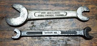

When we did Curator's Corner #9 a few months ago, linked here, we gave short-shrift to Snap-on, showing the early Simplex wrenches that Motor Tool Specialty was advertising alongside the in-house brands in the Second Wave section here...,
...dismissing the later Flank-Drive and dissing its historically blind and presumptuous claims...
The most we will say about that (patented in 1966, not TM’ed as a term until 1980, first commercial use in 1967) and all its iterations is that Snap-on’s marketing claim - to having “created a tool the industry had never seen before”, phraseology that they are still using today, is ******** only true of socket wrenches.
But we screwed up by even allowing ourselves to be distracted by Flank Drive, which is a milling that was always more about equal torque and not rounding off a nut anyway.
Between the late 1920's Simplex wrenches and the 1967 Flank Drive wrenches, we completely ignored the fact that Snap-on was making and selling what they were calling "Ratcheting Open End" wrenches.
The Acquisitions Dept found one yesterday, as well as a Simplex variant we did not have.

As far as we have been able to determine, the Snap-on ROE's were first introduced in 1948, and given part numbers with an RS- prefix.
By 1953, they were down to making four (4) of them, and they made them in those sizes through 1970.
In 1971, they started offering ONLY the smallest one in a handsome black oxide "Industrial" finish, they gave it a different prefix, and it was available until at least 1983. Oddly. Not sure why they didn't offer them all in that finish, but the catalogs are persistent and consistent on that.
P
30,981
What we have been unable to determine is the patent Snap-on was using for these wrenches, if any. Unlike many other inventions they proudly proclaimed and protected, they don't seem to have done so for these. If you recall, one of the themes of our Curator's Corner, was the interesting linkages between the patents via the "duty of candor" practice of patent citations as "prior art." We're curious where this design came from, frankly, and where it fits.
If you look at the figure at the lower right in the chart, used only to be representative of the type of wrench the chart was timelining, it might be quite the coincidental choice that it's the patent (Miquelon) that most closely resembles the Snap-on ROE series!
We're not saying it is. But it's interesting.

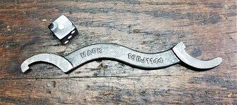

(1) Ca. 1930's unmarked leather tool bag, (2) ca. 1918 Wiggy, (3) 1930's Mack Truck wrench (made by Bonney), (4) 1920's Billings & Spencer No. 50 set, (5) 1930's STANLO set, (6) 1940's Holgate jeep pull toy, (7) 1934 World's Fair Templeton-Kenly baby jack souvenir, (8) 1950's Colonial "Ranger" boys' pocket knife, (9) 1930's Wyandotte toy truck, and (10) the ca. 1880's No. 2 and No. 4 Colt Patent quick clamps, shown with the No. 1 we already had.
