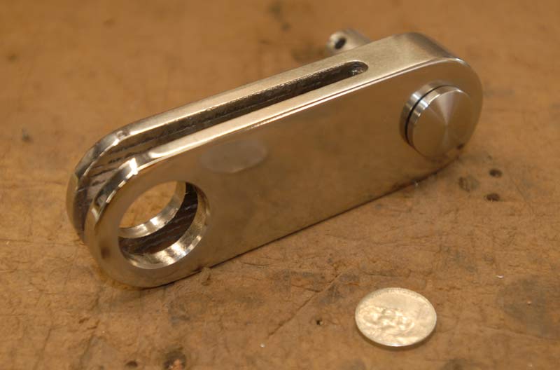

A little motorcycle project I completed. Took a few days of work since its all manual machining and I'm just an amatuer hobbyist at this. The shift lever on my new BWM F850GSA has an adjustable tip on it and I thought it would be better with a folding tip to reduce the chance of damage from rocks, tip overs etc. There are some aftermarket replacement levers, but why replace the entire lever when I can just make the folding tip and replace the original solid one.
It was a good excercise in some more challenging processes than I typically use.
Nice part, should work great for you.
