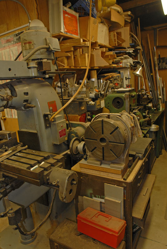

I have a standard series 1 Bridgeport. I'm not worried about moving it; just want a table that fits my machine well.
Monza Harry
Dec 29, 2018
1,433
Windsor ON
I bought an 8" for my Bridgeport, reasoning the "Almighty Dollar" The 10" was my goal but at 2 1/2 times the price this was a decent compromise, Mine came with the diving plates but no tail stock that will be another ~$80 US [about 120 Canuk dollars]. Realistically the 8" is pretty much the limit for using it vertically with any length of drill bits/cutters with a fair sized work piece mounted up. Dividing head is about 10-11" tall another 4" for your keyless chuck from the ~19" of head to table for your Bridgeport and you are there. Just some thoughts. Harry
lilscorpion
Mar 15, 2010
3,600
Colorado
SanDan, nice part! What size is the rotary table that you are using? I need to get one, but I have minimal experience with using one and I'm struggling on what size to buy.
Really the only constraint, as far as I'm aware, is weight. Even if the base is larger than the width of your table you can still attach it without issue. My rotary table may even be 16" in diameter (I forget) and works just fine on a series 1 style J-head mill.
I've never really used mine much since I converted my Mill to CNC. Not because it's not useful, but because I'll do whatever I can to avoid risking hurting my back again lifting the damn thing up on the table. I do refer to it as "that big *******" for a reason. I think I'd use it more if I had a gib crane (or some other lifting apparatus) which could help me get it from it's storage place to the mill. Because I can't easily, the storage place has shifted over time from "easily accessible for when I need it" to a place more "long-term and out of the way".
So...my .02 - Big as you can get it is super desirable but small as you can manage may just end up being the best approach.
matt_i
Mar 14, 2008
10,758
SE Michigan
I have a 10" rotab made by Moore. Seems OK, as above the VMC is more versatile usually, a 12" would be good too but that's a really big tool.
The thing I don't love is having to remove the vise, losing its alignment with the x-axis to put in the rotab. I've tried to put it right next to the vise in the center but then the table is usually way out at the end of the travel with the rest of it hanging out the other side.
Lacking an overhead hoisting system, Imo the best would be a rolling cart that you can set the mill table either 1/8" higher or lower with the knee depending on which way you are going with it. Then sliding it "slightly downhill" is very easy on both the tool and your back.
ClappedOutBport
Mar 30, 2016
998
I'm going to be the devil's advocate here and suggest the smallest rotary table you can get by with. I don't have a spot where I can stick a rotary table next to the mill, so I have to carry it. I am a young fellow, but heaving that >100lb hunk of iron up is still very difficult for me. One trip to the doc for screwing up your back is more expensive than just buying the bigger rotary table if and when you need one.
A neighbor was in the shop one day asking for some help, I asked him to help me move the rotary table to the mill. He slipped and dropped his end. I held on 'til it hit the concrete. If fell slow, but still fell. Had to stone it and I think the handle shaft may be slightly bent now. That one is a 12", I'd much rather have an 8" for most jobs.

Bridgeport pattern mills are 12 and 16 inch Y axis. I've never used a rotab smaller than 12. To me, picking a rotab hinges on the Y axis; that is what limits capacity of turning a disc. A good alternate might be 10" with a square subplate of 1/2" or 3/4" aluminum, square enlarges the clamping area and easier to find. Drill and tap an equally spaced dense matrix of clamping holes.
The unexpected drawback to a small table is when a subplate required for capacity. The locks and handwheel are hard to reach, the leverage of milling is outside the original envelope and makes climb milling difficult.
A part of machining is to manipulate tooling; lift table, engine hoist, overhead crane or a strong back.
I have a lift, commercially [Lucasey] made of SuperStrut/ Unistrut, a small cable winch, and 4 swivel casters. The lift surface is 1/4" x 1-1/4 cold roll bent to 90 and gusseted; the best feature. These arms attach with strut nuts, therefore can be preset as desired, even offset. The engineered capacity is 150 pounds.
