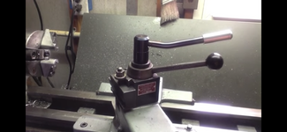

Started on my first lathe project last night. Not sure exactly what to call it... I’m making a lever handled nut for the top of the quick change tool post. It replaces the nut on top with a lever similar to the one already there for the wedge.
This is an example of what I’m making.
I cut a chunk of material from one of the rusty bars I bought from the scrap yard and got to making it smaller. Finish seems alright thus far.
I think the next step will be to bore and tap the thread that goes in place of the existing nut. Then part it off a bit long and flip it around to do a taper and clean up the top. I need some material for the handle yet. I don’t have a ball turning setup so I’m thinking I’ll make a more rectangular knob. So far so good. It’s only a 3” or so part and I have a few feet of material to turn into mistakes before I would need more material ;)

Looking good. Just FYI if you want a ball and don't want to deal with it, McMaster has them pretty cheap, already drilled and tapped and ready to go in a few different materials.

A radius cutting attachment is a pretty handy tool to have, too. Then you can turn your own ball for the lever. It can be a bit of a pain to get the threads indexed right. What I do is make the part a little long, then see where the lever ends up pointing. You know the pitch of the thread, so you can calculate how much more needs to come off for it to point the right direction. I'd sneak up on it, though. It's much harder to put material back than to take it off.
If you know somebody with a 3D printer, you can also have them 3D print a knob for the end and it can be any shape you want. I just saw a thing where a guy cast the end of his finger that he apparently cut off in an accident in epoxy for a shift knob!

Finished the handle project. I’m happy with it for my first lathe work.
