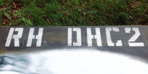

Growing up, I spent a fair amount of time around the de Havilland DHC-2 Beavers. They were the common means of travel around SE Alaska.
I've always loved the planes and the way they sound, especially at start up.
Most of them where on floats.
I recently saw one in full military paint.
Thought I'd take a stab at a "themed" table.
Freedom to fail is a part of my approach to furniture making. We'll see how this one turns out.

Damn the torpedoes, full speed ahead...
I like that approach!
Played a little with adding some "Patina". I'm liking it more already.
Dulled down the white and the yellow paint a bit. Looking a bit more vintage.
