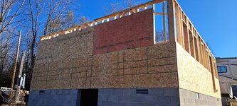

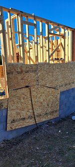

We finished up all the openings except one which we are using as a doorway. Also added blocking along the walls and in between joists where that living room wall ended up.
Does anybody have thoughts on those headers ??

Very cool project you and your wife have taken on. Will also be a really neat story when your son tells people he's living in a house his parents built!
You're making great progress!
I'll be following for sure!

Do you have any floor joists landing on those?
If it's not load bearing a flat 2x4 is sufficient and would be code compliant.
Article dealing with alternatives to the standard laminated 2x12 header.
There is one 24 inch window that joists will land on. I can't view the article, it wants a login.

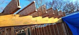

We got the LVL up in place today. I was exactly 1/8" off so I shimmed it with some plate aluminum I had in stock at my shop. Then I got all my measurements and started trimming down I-joists. According to my research I'm 1 ply overkill on that beam.

.........JOI-ST to the world.........
Got the rest of these up today. I just need to pick up some hangers so I can fill in at the top of the stairs.
