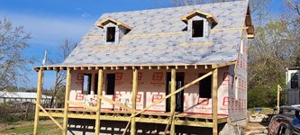

......STILL waiting on the windows which are now over 3 weeks late. Because of a local-ish tornado, the guys that roofed my house and will be doing this one are WAAY behind. BUT,....I loaded, and hauled upstairs, 23 bundles of shingles today. Then loaded another 22 bundles in my trailer but now I'm too pooped to go pack 'em up into the house!

Well........I'm VERY unhappy with the Epilay brand synthetic underlayment. During the crazy pouring rains we had 2 weeks ago the house was just pouring water in. Today we had a light rain......I mean walk around outside with no umbrella LIGHT rain. Here is INSIDE the house! It appears to all be fastened down and overlapped as per factory instruction. I just really don't know why this amount of water would leak right through the stuff.

I e-mailed a rep for the synthetic underlayment.......APPARENTLY, that stuff is "water shedding" UNTIL you put holes in it everywhere with staples and cap nails. my advice for anybody........stick with the tried and true self sealing asphault paper IF you actually want a WATER PROOF roof. I'm now regretting that we went with synthetic on my house and we might have the roofer tear this $hit off and replace it all with old school felt paper.

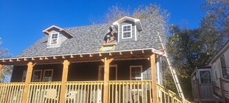

I forgot to update.......we got the roofers out (in between crazy rainstorms) and they got it shingled May 5th. He knew water would leak through but even HE DID NOT KNOW it would just come pouring in like it did. The good news is that the plywood took it just fine and there was no issues. The roof came out great!

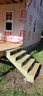

One more window in and I finally built porch stairs. NOW.....I can finish framing up the kitchen window and wall that we've been coming in and out of like a door. I guess I figured since we had a 97* heat index today I'd stand right in the sun so I could get 'em built.

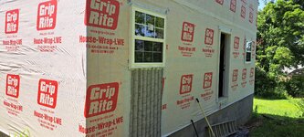

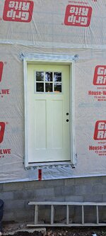

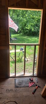

We made more progress today. The front and rear entry doors are hung. Then I framed in the kitchen window area that we've been using as a doorway. And we got that installed as well.

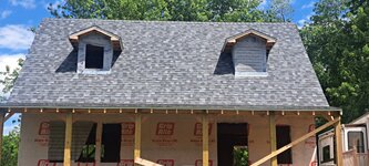

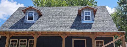

Well, it's been 100 degrees and sun a shinin' for weeks now...........but the weather finally broke. I just finished installing the 2 dormer windows. That was AFTER I made an angled stand with legs so I could sit up there on the 12/12 pitch roof!!

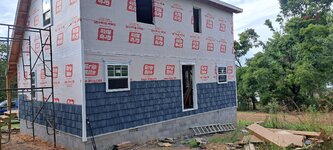

Today I figured out how to make the siding on the sides of the house line up with the front we already put on. As per Murphy's law, the lower edge of the side walls was JUST far enough down to throw alignment to the front OFF! Line up the sides with the front and had about 2.5" of wrapped osb showing..........GREAT, NOW WHAT?? I ran back to Home Depot and found some white aluminum 3" eave drip edge, hmmmmm..........this will work. By primitive means and some scrap lumber I bent out the drip edge to form more a "z". Just the right amount of flashing to cover up the bottom edge. Then I put on the starter strip and VIOLA.....the siding lines up and the lower side wall edge is covered.

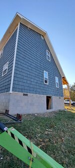

The 100* days finally broke and we took advantage of the nice weather. My wife and I spent the holiday weekend working on the siding. Another 2-3 boxes and whole first floor will be done.

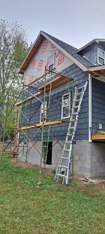

My wife and I set up another section of scaffolding and we got some more siding done today. SO many times up and down ladders. This bit took us around 5 hours but that includes about an hour moving, setting up, and leveling the scaffolding.

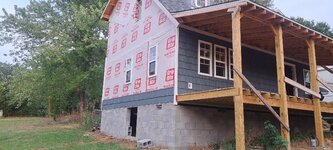

We put in more time on siding today.........YAY!! I finished this area in the rear top left, then we broke down and moved the scaffolding to the lower side of the house. I got that corner trim up and did everything above the window tops. It wasn't much but when you factor in moving the scaffolding and a lunch break, we got about 6 hours in.

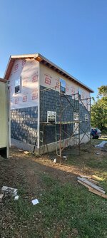

We got about another 5 hours in today before the rain moved in. I'm becoming a little more comfortable up on the second level of scaffolding but still don't like standing on one 12" wide walkboard!! I'm guessing I hung about a square total of siding and got a bit of soffit started as well. The purple rope with clamp is how my wife 'hands' me the cut pieces.

I built a little platform to work on the dormers..........it's just IMPOSSIBLE to stay put on this 12/12 pitch roof!! Well,.......that was a fail. after getting a little trim and soffit up I rode that sucker down flat onto the porch roof......NOT COOL! Watched some videos and saw guys working on foam. Bought this twin egg crate mattress topper at the Salvation Army thrift store for $10 and problem solved YAY! I've NEVER done siding before but managed to BS my way through one dormer......one more to go!

We finished the other dormer today.......YAY! Glad to have those suckers done. Also will be renting a towable boom lift for the weekend. The PLAN.....is to finish up ALL the rest of the siding, soffit, and fascia with it. Hopefully I feel better about being in a little cage rather than standing up on a 12" wide walk board. Also fit in the power vents on each gable end.

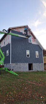

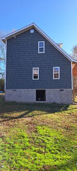

Well.........I did NOT get it all finished with the rental lift. It wasn't for lack of effort, it is simply because I DON'T DO HEIGHTS. I'm pretty nervous up in the air and things went very slowly. The good news is the TALL gable side is DONE!! I also finished up the soffit and fascia across the whole rear and most of that siding as well. First time I've EVER done any siding so wife and I are pretty proud of ourselves! I also found a couple surprises the roofers left me...........WHICH AGAIN.....is why I'm doing everything I can for my son. The so called 'skilled' labor these days is PATHETIC! I found this neat little 'OOPS' cut on the drip edge where the Main roofline meets the front porch. I took back FOUR leftover pieces of drip edge after the job!!! They could have just grabbed another piece!! I took a scrap, snipped and bent it, caulked behind, and slid it up into place. They were also nice enough to to pull the drip edge banjo string tight around both rear corners of the roof. I had to snip up about an inch to get enough room to slide the fascia in behind it. I just don't understand.

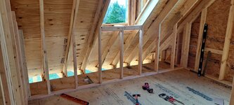

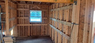

Today my wife cleaned up a bunch of trash and moved scrap wood around so I could start interior blocking. Here you can see the 'let-in' method I used to notch the studs for some plywood scraps. Kitchen is now all blocked out for cabinets.

We've been busy several hours every day this past week blocking. Most of the first floor is done. Pic of small bathroom medicine cabinet blocking and utility room.
