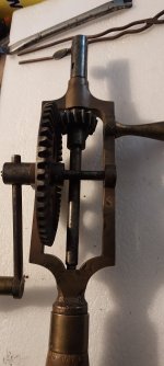

Super cool Ornate hand drill haven't found any markings yet
I have 7 or 8 breast drills very similar to this on, but all of them are slightly different. They make me wonder if someone made and sold the frames and gear sets and then the rest was owner made. But--at least one of mine has an iron frame while the rest are bronze colored metal, and not all the large gears are exactly the same diameter. So I keep buying them when I can afford to. Notice that the axis of the large and small gears don't align so the gears are slightly helical.

I definitely had that thought. There seems to be a few pieces I have seen that are identical on a couple other examples like the adjustable crank handle and the other side handle making me think it's possible there was a little bit more than the frame being supplied, but I don't really know. One thing I notice is difficult on mine is the curved bottom part of the frame. This one I found on the Jim bode site is very similar as well.
