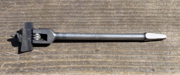

Yesterday was expansive bit day. I finally found a replacement for my early broken Convalco bit that Ives in my NAF toolbox. It came from an eBay seller. The large cutter was missing

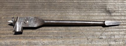

I cleaned up this rusty bit found at a recent estate sale.
it turned out to be a Greenlee wheel adjusting bit in quite good condition. IMG_8422.jpegIMG_8421.jpegIMG_8422.jpegIMG_8423.jpegIMG_8424.jpeg

Take the broken one, cut the end off and then grind a screwdriver tip on it. Or is you can weld, put a 3/8" square drive end on it. It can still be usefull.
