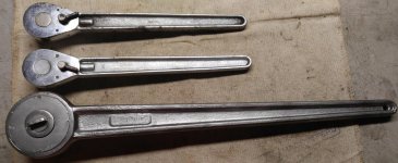

Today we are going to move to Mankato, MN and check out some Truth Tool examples, and then move into Chicago.
These Truth branded ratchets are relatively rare. The 2 1/2" drive examples are fairly common and made from the late '30's to the late 40's. I'm not confident on dating the 3/4" drive but they were not present in the '31 catalog. The '31 catalog is the earliest I have that shows ratchets, sockets and drive tools. The 1/2" drive ratchets in that catalog match the style of the 3/4" drive in this post, but their smaller 3/8" drive offerings had round shanks that "squared off" near the head, and the head is round style as well.
Most examples of the 1/2" drive ratchet shown have the "BS" forge mark. We have yet to identify that drop forger so if anyone has thoughts on who that might represent, please share.
From top to bottom:
- 1/2" drive reversible ratchet Model R-6 - circa 1940's
- 1/2" drive reversible ratchet - no Model number but same as R-6 - late 30's to early 40's
- 3/4" drive reversible ratchet - no Model number - unknown dating.

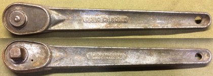

I did just pick up an early non reversible Duro ratchet with removable drive plug. I haven't had a chance to clean it up yet, but I can confirm that it has only 16 teeth. It's difficult to make out, but above the drive plug, it reads 'CHICAGO, U.S.A.' and below the drive plug reads 'LICENSED UNDER PAT NO.
I know we're about to move onto Chicago production, so... here's some pics: :lol:

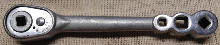

These are the female reversible style with driveplug. All date from the mid-1930s to about 1950.
From top to bottom:
- Patent number stamped under selector - 18 teeth
- Patent number stamped under selector - "No. 3202-R" stamped on face - 18 teeth
- No markings whatsoever - 18 teeth
- Patent number stamped under selector - Model "4490 Duro-Chrome" stamped on the face - 20 teeth

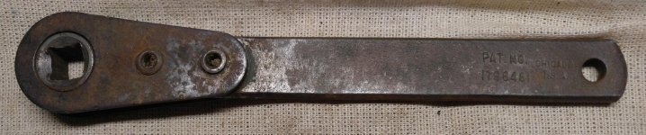

Yup, I agree. I posted it how it came though. Without a model number stamp I doubt Bonney though. I think I remember the 3rd one down had a model number.......3214?

Since you mentioned Truth ratchets...I've looked for a while and haven't seen one like this. My mom actually bought it for me at a flea market because she thought it looked cool.
1/2 drive, push thru plug (non-removeable), 27 teeth, 10-7/8" oal.
One side says -TRUTH-, opposite side TRUTH TOOL CO. MANKATO MINN. No other markings or a pn.

These are the open gear Indestro Select Model 6470. Again, maybe Brian can help with dating.

Here we'll move on to the round head style, all based on patent #2686582. Again, need a little help on dating these.
From top to bottom:
- Wizard 3/8" drive Model H-2775
- Indestro 3/8" drive Model 2775A
- Wizard 1/2" drive Model H2833 (x4)
- WardMaster 1/2" drive Model I84-4860-R
- Duro-Chrome 1/2" drive Model 675

And last but not least from Duro-Indestro, the pear head design which I happen to really like. I believe I have found the patent #4277990 (click the Images link). This patent was awarded in July of 1981.
From top to bottom:
- Wizard 1/4" Drive Model H-2750
- Duro-Chrome 3/8" Drive Model 4472
- Westline 3/8" Drive No model number
- Indestro 3/8" Drive Model 6272 (x5)
- Wizard 1/2" Drive Model 2831

My meager contribution for the day. My vintages ratchets that live at work and see use next to my modern snap on ratchets.
New Britain made, my favorite is the long handled Mac 1/2" drive, the close second favorite of the bunch is the 3/8" flex
My Cornwell, I use the hard handle frequently on oil changes, not sure how old it is, I bought it used off eBay a few years ago. The short handle is a recent find, but it has been useful a few times.
