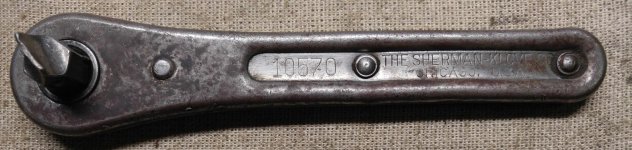

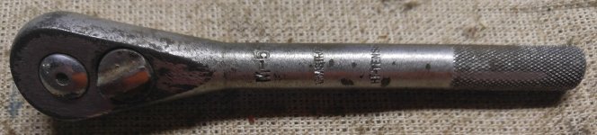

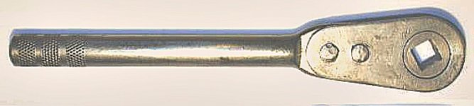

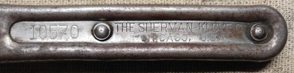

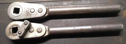

These are the two earliest styles of S-K ratchets.
First, the pressed steel 1/2" hex drive Model 10570 - 1932-1933 (The reverse is stamped exactly the same as shown.)
Second, the 1/2" female non reversible. These ratchets were branded (at least) for Sears Fulton, S-K and Brazil. These two examples are unmarked and the example with the drive plug came in the Brazil set. They are unmarked and date from 1932-1934(ish)

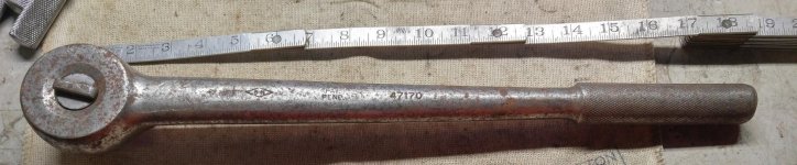

I wish to go back to this statement:
Next is patent #2188846 awarded in 1/1940 and again, I've never seen an example.
Raiderhillbilly PM'd me to let me know this patent applies to the 3/4" drive 47170. This example is "Patent Pending" and the head has been modified such that I cannot remove it. Perhaps someone could post a pic of the internals? Given this is stamped with the patent pending, I date this from 10/1938 - 01/1940.
Todd I have another version of those two, unmarked. This one isn't mine, I can't find the pic on my computer. I assume that the they are all from the same time frame, but made for different customers.
T
twertsy
Jan 5, 2014
6,726
Reedville, VA
Mike, I believe that's correct. Just differed in the knurling pattern.

Whoa man :drool:
That Armstrong M-51 is really nice. The HI-TENSILE marking dates it to wartime.
Hard to find anything in my meager collection to add.
Along the same lines as the Fleet and Penens ratchets is the Tru-Test 1661 version. And a pic of a newer Challenger 1660+. Both 1/2in drive.

Sure thing, Todd. Yesterday's flea trip was a bounty of ratchets. I usually don't find as many as I did. So, hopefully I'll have more to share as this thread progresses.
Here's an odd duck that I found yesterday. So unusual, I just couldn't leave it behind. Marked 'Harper-Wyman Company Hinsdale, Illinois'. Obviously built for a specific use. What got me was that it's reversible.
