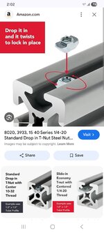

The slots in this extrusion are too shallow to use a t-head style bolt. The unit came with the flat-head carriage bolt things and those seem to be about all that fits.

Have you tried looking through the 80/20 catalog for a drop in nut?
I won't say I use this stuff everyday, but I do multiple times a week. Im sure you can get a drop in nut that works.
They're narrow enough to pass through the slot opening, then they rotate/index when you tighten them and pull up to the back side of the slot. There's a bunch of styles of them, drop in, roll in, all kinds of shapes, etc.

Very cool, thank you. My trailer is a Trailex, and I think they sell something similar, but it'd be good to have another option (the 80/20 catalog).
