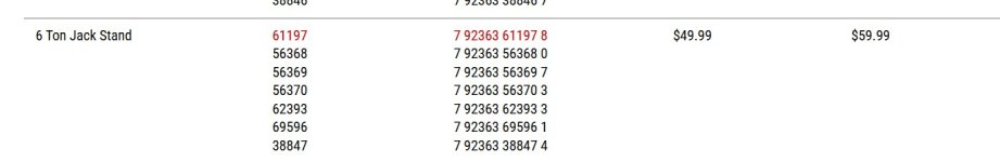

While working in the garage this morning, I started looking at my jack stands. Their old, rough, and one got bent. Before I started stripping them down to get ready for paint I decided to check into the whole harbor freight recalls. Well these particular model feel under the it’s not recalled but you can bring them in for store credit.
So I took all 6 in and got my store credit. Then I purchased 6 of the 6 ton Daytona jack stands and I only had to put 60 cents toward the gift card to complete the deal.
These new ones have a better foot print, looks to be better built, and has a safety pin as a secondary lock.
They should do good for what I do.
I have an orange pair that look like yours.
How did the recall/ exchange/ credit work if they were not the model listed in the recall? I am not sure mine have any stickers left on them.
So when they did the recall, they had specific model numbers that were listed as do not use as they are highly skeptical to failure. But they also listed some models that wasn't really skeptical to failure based on report but if you want to bring them back, they will give you store credit or a refund. Mine fell under the it's not known for failure but can be brought back list and they were the 38847 model. Mine surprisingly still had the stickers on them so the model number was easy to find.
The red model numbers are the 100% stop using due to reported failure models, the black are up to you if you want to bring them in.
Here is the link to the details on them.
