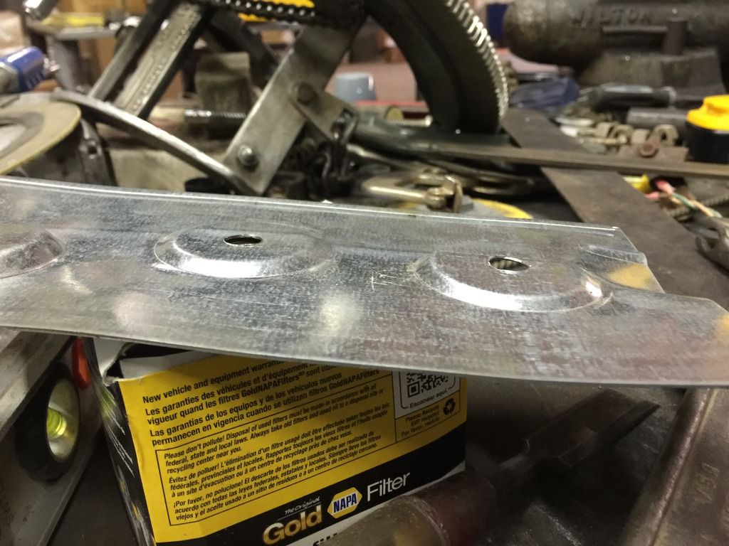

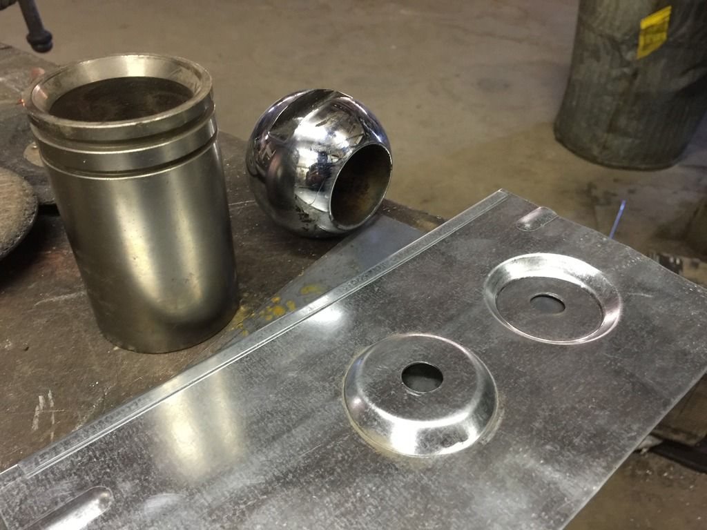

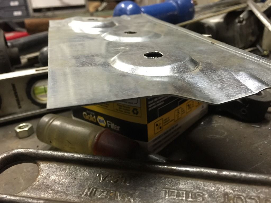

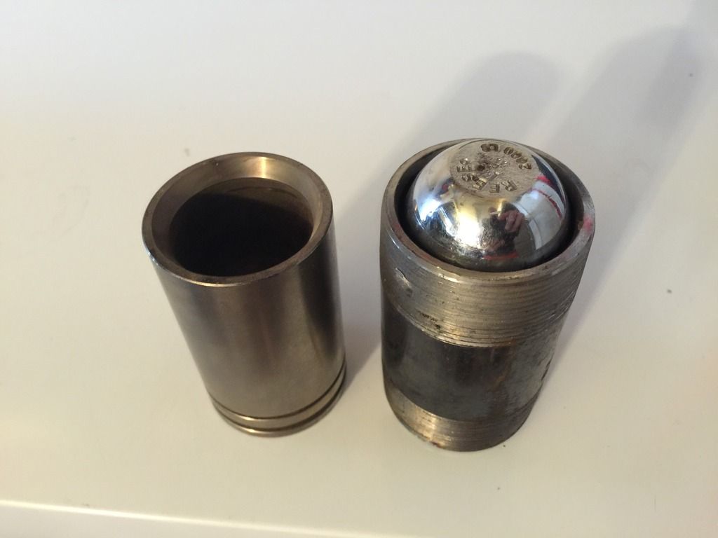

Ive been getting worse at remembering to take pictures of stuff, but atleast here is the finished washer fluid tank cover
And some quicky exhaust hangers , 1/8"

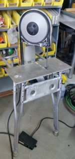

This isn't for the competition. It IS my own work, but I used the SWAG dimple die set.
This is the stand I built, for the Milwaukee portable band saw. I put a plate on the front to stamp some identifying information and decided there was enough room in there for a couple of dimples.
Here is my setup. The SWAG dimple dies, with the HF knockout set, with a foot-controlled air-over-hydraulic pump. About $800 USD for everything you see here, for 5 hole sizes.

I like how Machine_punk used crutches for his saw stand. Very creative.

Reddittj
Dec 8, 2016
4
I'm assuming I'm putting too much pressure with the press to get the deformation.
The middle one I didn't press as far, I went till the sheet deflected back flat. I used a bolt on the middle and it was mostly straight.
I have some knock out punches that I am tempted to try to create a larger hole. Is the larger hole with just the rim flared just for aesthetics? It does look better.

( I'm assuming I'm putting too much pressure with the press to get the deformation. )
Actually what is happening is that you are drawing the material into the die, in effect shrinking the sheet in that spot and creating warpage. That's why we use a larger hole with matching dies.
( Is the larger hole with just the rim flared just for aesthetics? It does look better.)
It stems from aviation. It reduces weight and once dimpled gets a whole lot stiffer. It also just so happens to look pleasing to the eye.
