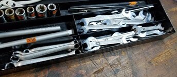

If we're going to blitz on this Tiny Tools sub-topic, let's really blitz! :)
I think you guys know I use this old New Britain display case to keep some of mine in. I have been picking them up for a long time, pouched sets when I am lucky, but usually onesy-twosie.
Here are the pouched sets. Top to bottom, left to right: New Britain, Duro, Duro, Wilde-made "41-W-900", Kastar, Misc., and 30's CRAFTSMAN.
