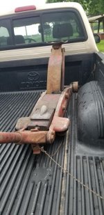

I'm waiting in a parking lot in Ft. Worth, TX for another S4 jack pickup. I have the high ground covered.

Awesome! And still has a lens....:thumbup:
You must be the king of S4 jacks by now. How many are in your collection?

Normally, I have seen the aluminum framed jacks with some additional web stiffeners on the upper forward side of the rear caster housings. I don't see these on your jack.
This might have been a problem area for theses jacks with the aluminum side plates. If that's the case, you might have an early production aluminum framed S4.

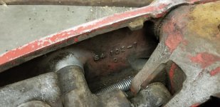

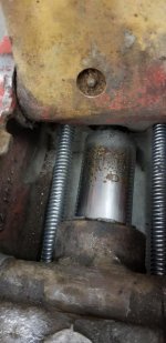

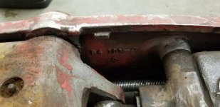

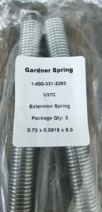

A little work on the S4 today. Return springs came in from McMaster Carr. The new springs are 8" but they have more turns then the original. I would have rather had a size closer to 13/16" then 3/4". Should i try and remove the rust from the cylinder?
Jack was very low on fluid and after filling it raises and lowers just fine. I'll see in the morning if it has a leak.
