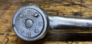

On Sunday, I picked up this freewheeling ratchet. Looked a bit worse for wear, but it cleaned up well.
The problem that I'm having is that it wants to just change direction instead of 'freewheeling'. It's not seized and I can get it to freewheel in both directions by spinning the back side of the mechanism. So, something in there is just gunked up. I'm soaking it now in penetrating oil, and if that doesn't work, I'll give the ATF/Acetone a go.
The ratchet is dated -7.
Before/after
I'm trying to picture what it's doing. When it's set for righty-tighty, it should grab turning to the right. Then it should freewheel (gearlessly, instead of ratcheting) on the backswing to the left, until you turn the handle to the right again, when it should grab again. And so on. When it's set for lefty-loosey, everything is the same but the opposite.
So, is it grabbing to the right? And if so, what happens when you turn to the left? Is it grabbing that way, too? Or is it not grabbing in either direction?
I guess I can't picture what "it wants to change direction instead of freewheeling" means it's doing.
13,348
I've had one ratchet where that happened. As I would freewheel it backwards, the shifter would change from drive to reverse. When I disassembled it I saw nothing grossly amiss, just dry and crud filled, but a good clean and lube, and the problem disappeared. Mine was a Craftsman 44975 1/2" drive.
I'm sure I'm not explaining it well. So, there's no lever to change the direction (on/off). When it's working property, you have to use two hands to change the direction. One hand on the 1/2" drive end and a thumb on the other side. Then you twist the 1/2" drive side and it'll click into the other direction.
In a perfect world, after you changed the direction, it will freewheel on the back stroke and engage a fastener on the forward stroke. In this case, you can engage the fastener in either direction just fine, but on the freewheel stroke, it will just change direction. From off to on or verse vica. Something is gummed up.
It's starting to work a bit better. We'll see.
30,871
Hmm. I have two. They look just like yours. I've never seen one without a button to change direction. What does the thing that looks like it's the button do? Nothing?
EDIT: If that button is not disengaging, that is the culprit. Yeah, you have to twist the drive stud in the direction you want to switch to, but you can't do that without pushing the button. If you can twist your drive stud either way, without the button, it's not engaging and disengaging properly.
30,871
Trust me, it's a button on mine. Unless there's some version of a Blackhawk freewheeler I don't know about, I'd bet it's a button on yours, too. If I don't push the button in and hold it in, I can't twist the drive stud into the new direction. If it's already freewheeling in that direction, how would a twist in the same direction make it grab? It has to disengage first.
They actually take some getting used to, even when the button IS working. I've seen several guys think theirs wasn't working when it was.
In your case, I think your button is not working and it's not disengaging properly.

Thanks Lugz. My only other experience is with the ‘bald face’ ratchet.
Sure looks like a button. That mechanism on my ratchet is not sitting ‘proud’ of the face on the ratchet. So it’s likely jammed in.
Damn
30,871
And if that doesn't work, I myself would be inclined to hold it, or block it up in something where it was on its back but with the button free to travel, and giving the drive stud a good whack or two with a rubber or wooden mallet. I'm no tool beater, but that thing has been beat on the opposite side.
