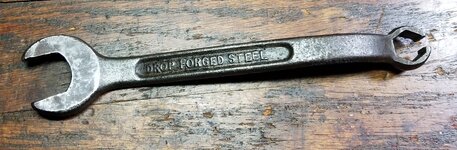

70089026690__C89B6193-F1B9-4252-836C-7DA560ACC70A.jpg01212_cNGt6HyFTDO_0t20CI_600x450.jpg00r0r_3volijmZssF_0t20CI_600x450.jpg00000_76NUq4pp18E_0t20CI_600x450.jpgwt cvxa.,olfdgf.JPG

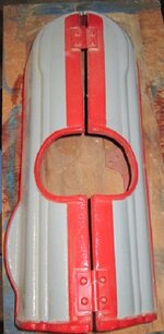

I have a Walker Turner 1100 that I refurbished utilizing two separate 1100's.
They were in bad shape, but I got them both for $150 so I figured I could make one good machine out of the two.
As found at a shop that was closing.
Here's the latest progress on the combination of the two.
I repaired the damaged cover, but haven't mounted it yet since I need to make some new brackets for it.
