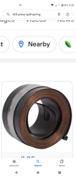

I think your spring needs a slot behind the hole so spring slips over hole then sits in slot which is diameter of stud smaller than head.like the picture

Thank you for the picture! Perhaps the spring had one but the tail end of spring broke off and the previous owner drilled the holes in the remaining end?

I had a friend come over and help me get a spring on one I fixed up for a friend
The spring was broken so redrilled correct hole diameter for head , then used die grinder to make slot. Wound spring on the press then slipped cast cover over it with slot slipping into cover. It was not the easiest job but we did get it wound and cover on. Also I do think you have correct pin

I think the extra long tail after the hole may be a problem also. Try to bend the last couple of inches to a smaller diameter to stay closer to the shaft too.
