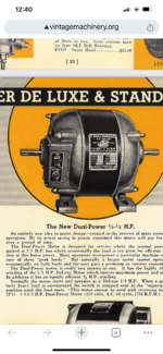

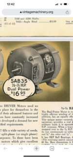

Love the W-T thread! I just got an old motor cleaned up and running. Love this thing!
As I got it.
And cleaned up.
Dual power 1/3 & 1/2 HP
As far as I’ve been able to find, it looks to be a 1936 model based on the badge logo. From vintage machinery web, a couple of screen shots one from 36 - the introduction of the dual power and one from 37 with the new badge. Then end bell cover looks to have changed as well.
